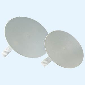

Hi Claudia,
don't worry about plastic covers. They are made to cover connection "boxes" inside a wall. They have a flat surface (to be painted the same as the wall) and plastic prawns to fit exactly into the circular outlet box. Fitted correctly they are almost invisible.
You can purchase them at any good electric shop.
I don't recommend to fill the box with concrete or anything else. If you need to get to the cable at a later time you'll be in trouble removing the fill without damaging it.
If you are located in Germany, these covers are "Abdeckung für Abzweigdosen".

Take your pick Claudia, they are a standard electrical item.
Hi Eric,
I'm sure you won't be mad if I suggest one of those. They are made for 60 and 70mm (2.36 and 2.75inches) diameter to fit snug over the outlet.
They cost the astronomic sum of 17€Cents each (including 19% sales tax).
Just slip the cover into the outlet and you're done.
(Made in the land of thinkers, tinkerers, poets and what else you wish :) )
Kind regards
Hans

hi Hans,
Thats a simple neat solution.:)
