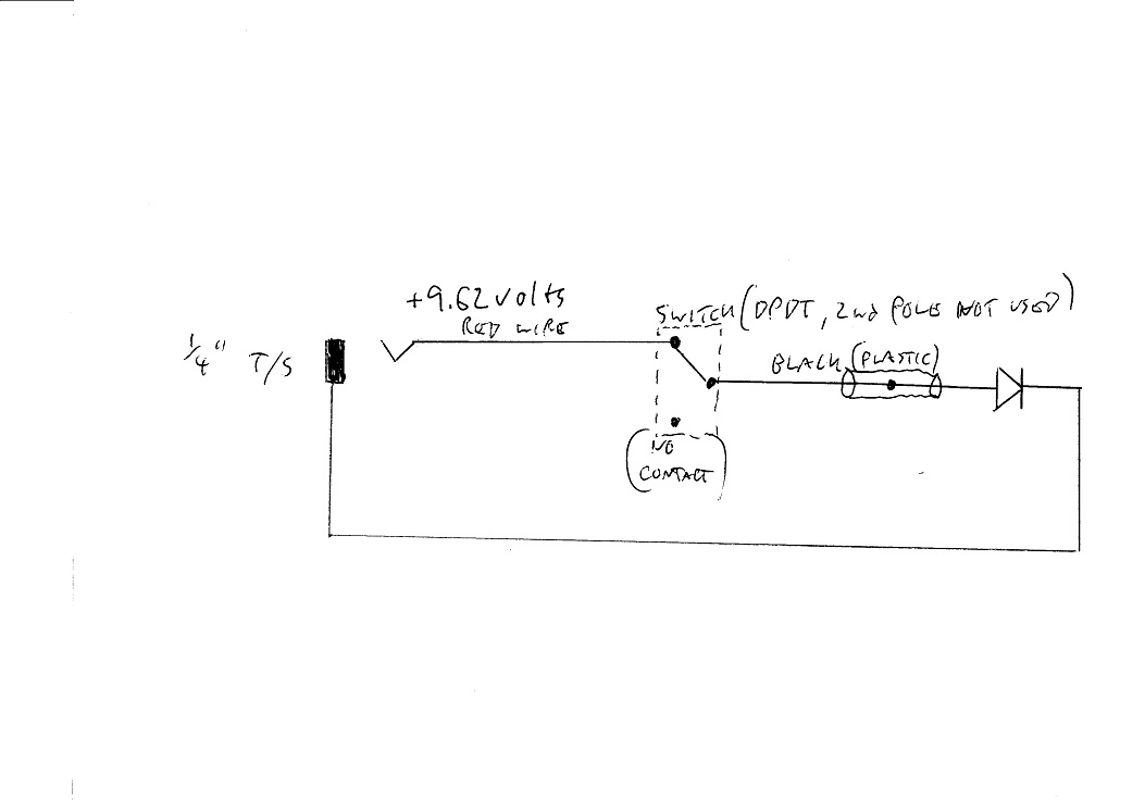

It's hard to make out what's going on there. Can you post schematics of your pedal, old foot-switch and amp? What does the LED indicate?
Thank you for your reply alec_t. I looked at the old footswitch again, and the reason I get zero ohms is that there isn't a resistor under the clear plastic sleeve that is covering it. It was hard to see at first. The sleeve covers the join between the LED and the wire going to the switch. sorry about that. Here is the diagram of the old foot switch. (My apologies if I have drawn the LED the wrong way around). So since it doesn't have a resistor, I guess I'm going to have to find the voltage drop across the LED. I don't know how to do that yet. Can I just hook it up to the amp and put a DMM over the LEDs leads?

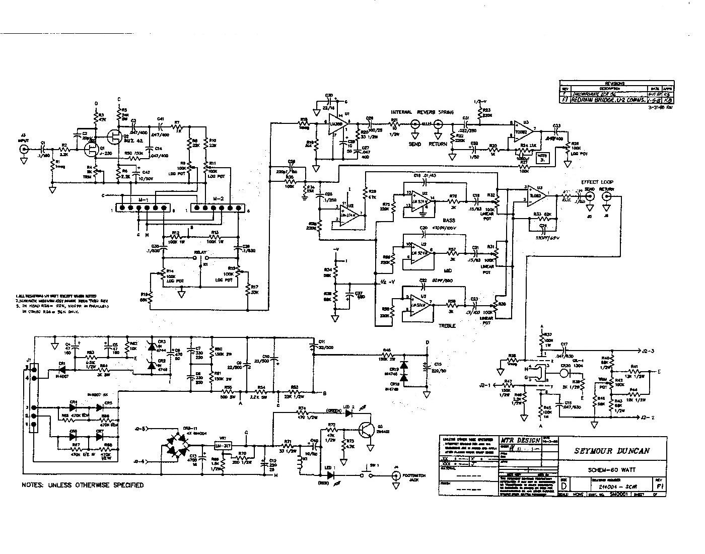

Here is the schematic of the amp. You can see the relay in the upper left corner that switches between the preamps. The amp switch and jack for the footswitch are in the lower right corner. Its hard to read the values so let me know if any of the values will help in figuring out the voltage needed for the LED in the footswitch. Thanks in advance!
OK so I plugged in the foot switch with the bottom removed, and tested the voltage drop over the LED while it was lit. The voltage drop is 2.252 volts. Does this sound about right? Is it possible that the relay circuit is 7.37 volts?

From the bottom of the amp schematic it is clear the relay coil K1 is in series with red LED 1 and also with the LED in the footswitch, so that's why you don't see or need the usual resistor in series with the footswitch LED. Operating the pedal grounds the relay coil bottom end via both LEDs.
Your new LED will be fine in your new pedal without a resistor.
Thanks for that alec_t. The LED that I have purchased (with resistor for 9.6 volts lol!) is a Super Ultra-Bright LED rated at 2.0 vdc typical, and 2.4 vdc max. Average 50 mA and peak 200 mA. So it looks like it will work like you say.
Interesting to note: the mA across the tip/sleeve of the foot switch cable is 66mA (and it changes to the red channel), but when I toggle the foot switch to open so I can read the mA across the LED as well, I get 49.4 mA. Do you have any idea why it is less and not more? (remember I'm an amateur, and that includes working with a DMM !). Thanks
It occurs to me that perhaps you were hoping to power other items in your new pedal from the 9.6V? Unfortunately, the pedal switch merely provides the path to ground for the relay and LEDs, so the voltage in the pedal is 9.6V without the pedal pressed but will drop to ~2V (the LED forward voltage) when the pedal is pressed.
Regarding the mA values, can you confirm the voltage between points G and H (bottom of the amp schematic), and/or the values of the two resistors connected to the LM317 voltage regulator VR1?
Thanks again alec_t. No I wasn't going to try to power anything else from the 9.6 volts. There will be a couple of LEDs in the pedal (to indicate loop A or B active, and a blinking LED to indicate the loops being bypassed) that will require a separate power supply, but for now the pedal will be passive and will be able to run without power if necessary.
I don't want to open up the amp at this point so I don't have the values for G and H. The resistors for VR1 are 1.5k (1/2 watt) and 200 ohms (1/2 watt). The 1.5k (R69) is the vertical resistor and the 200 ohm (R70) is the horizontal resistor.
