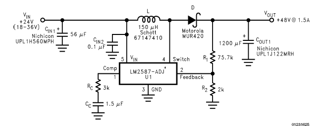

national LM2568-adj
If I built this I would use a UC3824 + (BIG FET) and diode with center tapped coil (transformer).
You need something simple! This idea uses a LM2568-adj. (use heat-sink) The coil will be easier than a transformer, for you. For 12V in and 48 out you will only get 1amp but you can build 4 and run them in parallel. Build this and then we can talk about running 4 in parallel.
Yep, the Simple Switcher range are pretty good devices. A lot of the manufacturers have software on their pages to allow you to 'design' buck boost convertors with their products.

I think i will fix this circuit:
Please if you can see the picture tell me your opinion about it!
