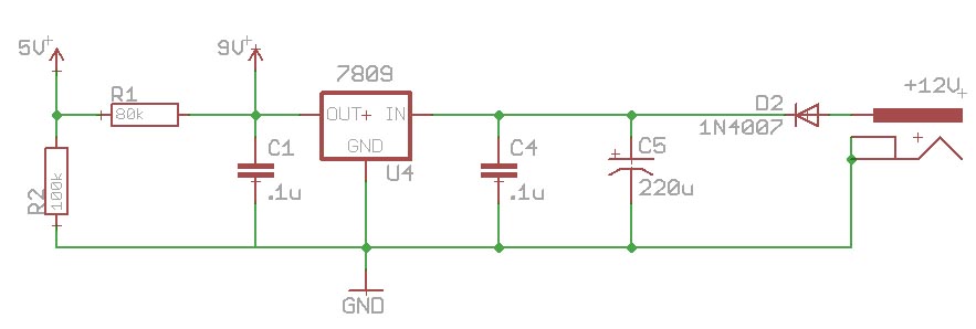

So if I keep a 9V reg and then use a voltage divider like this would it make more sense?
5V will control a PIC, 2 LEDs and a piezo.
Mike
The two resistors produce 5.0V only when they have no load. The 5V will drop when there is a load. It will probably drop so low that the PIC, LEDs and piezo will not work.

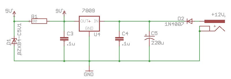

A zener diode and a resistor may be a good enough 'regulator' for the 9V stuff and might be cheaper than a regulator. Then you could use any wall wart of suitably high voltage.

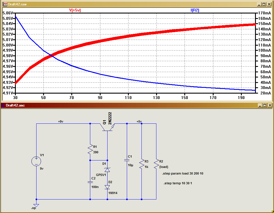

If you have the odd components in your bits box, this is a very simple 5Vreg.

Ok so I presume you meant 5V so I would do something like this?
I believe the 5 Volts is more important than the 9 volts.
The 9V is for Op-Amp and a comparator which can withstand 2V to 16V
