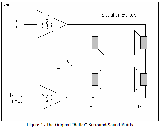

Connecting the rear speakers in series and to both hot terminals of the stereo amplifier is The Hafler Method of cheap and simple surround sound. it was invented in the early 70's. I used it with vinyl records. Its front to back separation is very low but it is audible.

The simplest "surround sound" system was the Hafler circuit. It produced very little front to back separation.
Here is an article about the Hafler surround sound circuit: **broken link removed**
The first one has 3 channels: left front, right front and rear. It uses only a stereo amplifier and 4 speakers.

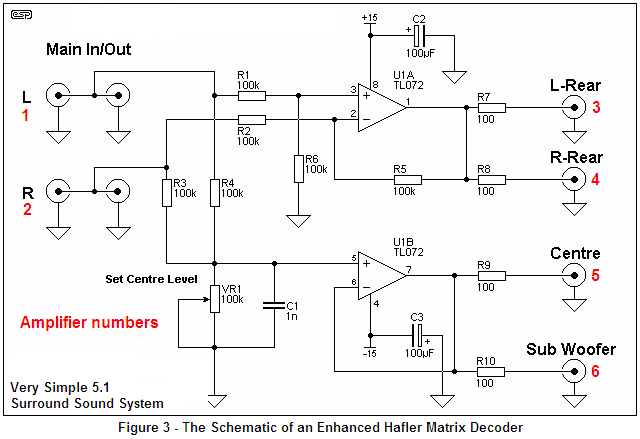

there's also a way of using op amps to do addition and subtraction. first you buffer the R and L inputs, as well as feed them into gain of 2 op amps. you now have the following signals: L, 2L, R, 2R. for center channel, sum L+R. then you need to subtract some signals with a diff amp. for L front, use 2L-R, for right front use 2R-L. for the rear channels: Surround L is L-R, surround R is R-L. it's sort of a modification of the Hafler surround, but gives more defined channel separation. and it's all done with op amps.
so,how about surround schematic use 6 amplifier and 6 speakers?
It is a very simple circuit in the article I linked to. It uses 6 power amplifiers. Since it is very simple then the front to back and L to R rear separations are very poor. I copied it here:
