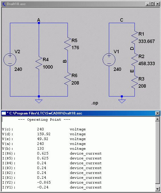

Pop Quiz:
Three resistors are connected to a source of 240 volts.
The first resistor passes a current of 240 mA. The second has a voltage drop of 110 volts and the third one has a resistance of 208 ohms.
Find: 1) V1=
2) R1=
3) R2=
4) I2=
5) V3=
f) RT=
Can anyone figure this out and explain how to? Thanks.
This is a very simple problem.
Firstly, you are told the current through one of the resistors in series is 240mA. This is the current though all the resistors because they are in series. By Ohms law, the total resistance will be 240/.240 = 1,000 ohms.
The third resistor is 208 ohms and the current flowing though it is .24A This means the voltage across it is .24 x 208 = 50v
The voltage across the first resistor is 240 - 110 - 50 = 80v
The resistance of R1 = 333R
The resistance of the second resistor = 1,000 - 208 - 333 = 459R

Do you know Ohm's law? Do yourself a favor, draw out the circuit with the 3 resistors in series. If you don't know what series is, then ask. The circuit must be series, because I don't think it is solvable otherwise. Once you have the circuit drawn, then draw an arrow over each resistor, and write 240mA over each arrow, to remind yourself that the current is the same for each resistor. Now, you should know that all the sereis resistors added together is the total resistance for the circuit. Also, you can calculate the resistance for the one who's voltage drop you are given, because you have the voltage and current, so use Ohm's law to get the resistance. Now you have the values of two of the three resistors, and you know the total resistance ( hint: it was given in an earlier post ) It's a simple addition to find the value of the remaining resistor ie R1 + R2 + R3 = total resistance.
That's just about all I can do without doing it for you.
