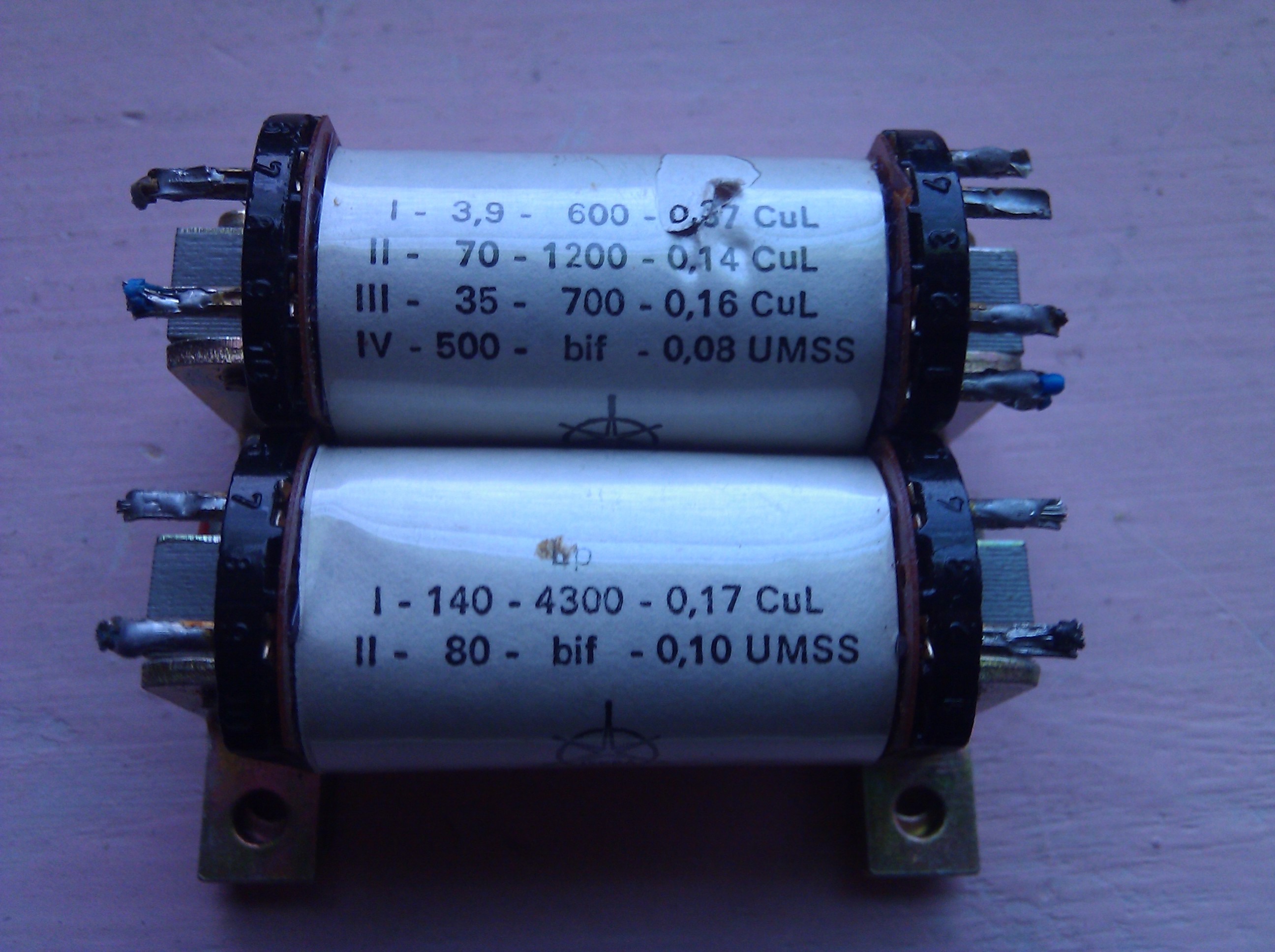

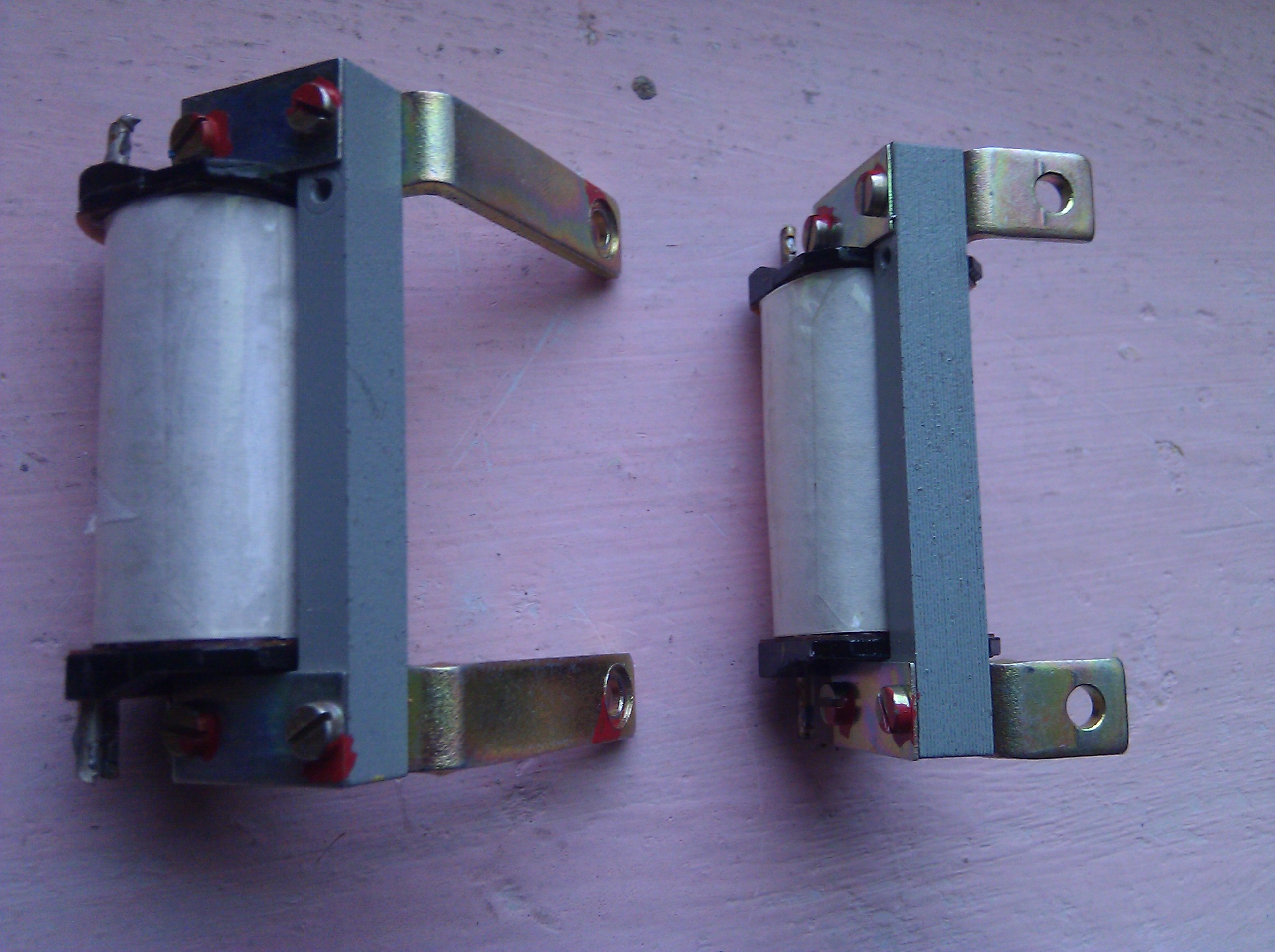

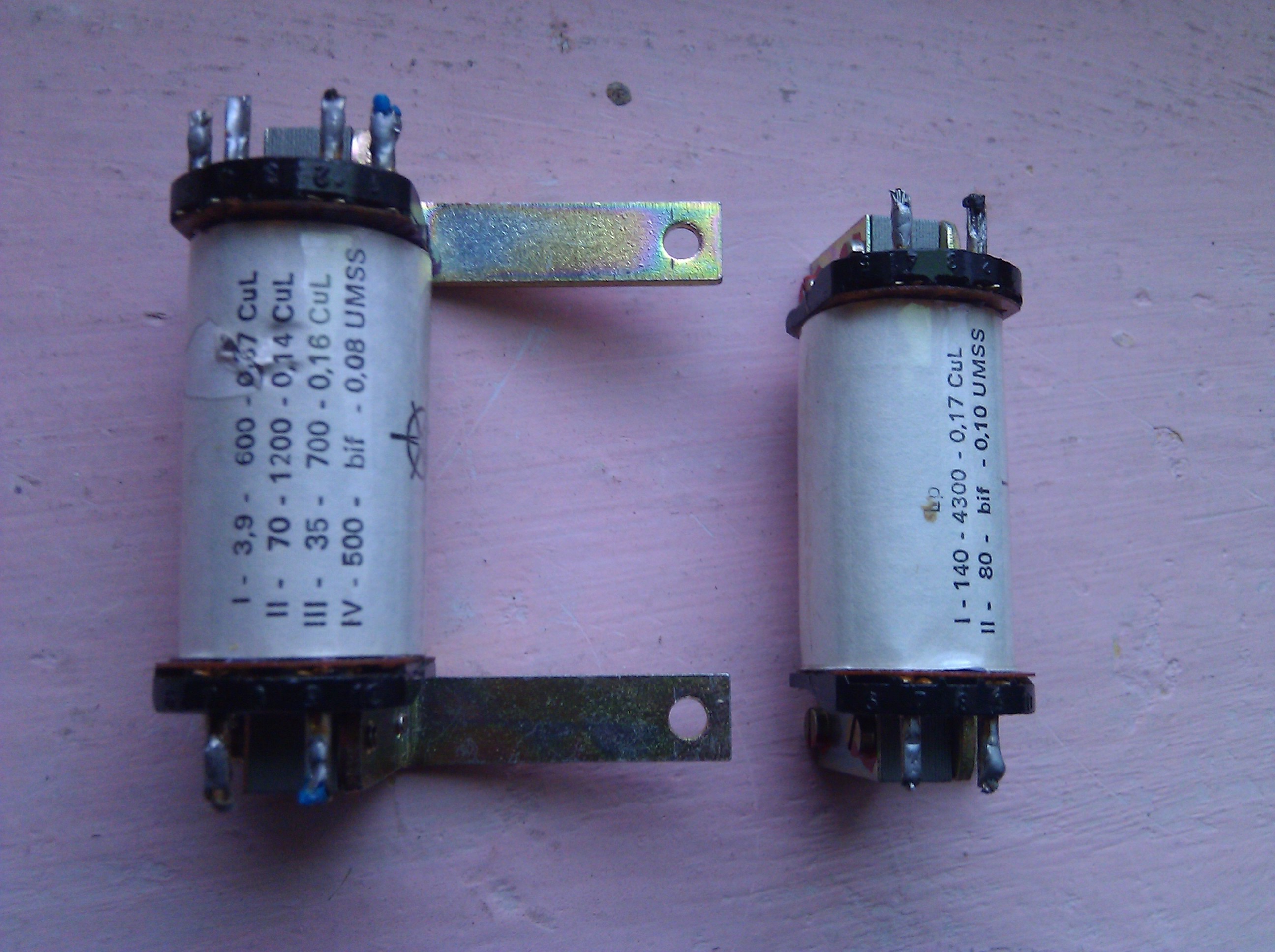

I have two coils but dont know what is it, Posibly a transformer
I find a old telephone ( polish m63 ) and took it a part now i have this two coils and i don't know what is it for, there were three the third one is for the bell and it works, but this two i don't know i think it is some kind of a transformer, step up i hope cause i wand to build a electric high voltage fence. can somebody please tell me what is the coils on the pictures used for and can it be a step up transformer?
You might in theory be able to use the chokes as part of an electric fence, however the insulation probably isnt good enough, 'phones usually operate at 50v.

Old telephones are full of windings for matching line impedance, or generating side tone, providing current limiting for the carbon transmitter, and a heap of other obscure requirements.
There is no way these coils would be applicable in a electric fence energiser.
The electric fence energiser has a specific output waveform. The waveform is limited to around 4 Kv and this is done by using Voltage Dependent Resistors across the output. The waveform is generated, in the ones I have seen, by charging a capacitor to around 600 volt DC. The magnitude of the stored charge is related to the need to NOT KILL anybody. When the capacitor reaches its required terminal voltage, a switching device (SCR) is triggered and the capacitor discharges through a transformer primary winding. The transformer secondary is loosely coupled to the primary and it rings at a frequency to give a rise time of around 12 micro seconds (from memory).
