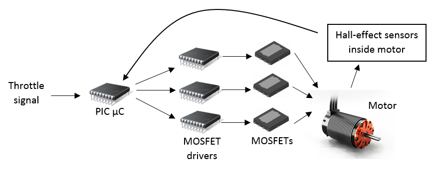

I'm building a high-current 3-phase brushless motor controller and have found a high & low-side gate-drive IC and N-channel MOSFETs for the circuit (see bottom for links).
Circuit details:
The gate-drive IC uses bootstrap operation and can supply 4.5A source/sink gate current.
VCC = 15V
VDC (voltage to the load) = max 42V (10S LiPo cells)
Max load current = 200A
MOSFETs in parallel to handle high current = 4

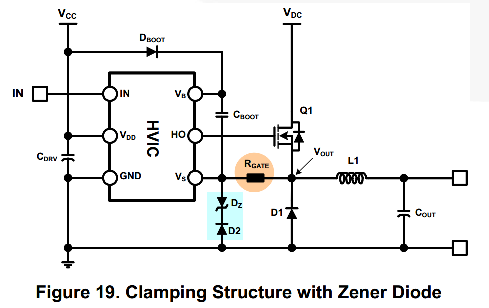

I think I have come to the conclusion that the circuit in figure 19, page 7 would be the best way to design my circuit (attached).
I'm trying to follow the AN when calculating bootstrap capacitor and gate resistor values but the AN has a bit bad english and the calculations makes little sense to me.
If I was to calculate the gate resistor, I would calculate the resistor value needed to limit the current to 4.5A at 15V = 3.33ohms. But when calculating it using the formulas in the AN, I get 57.7ohms.
Using the AN to calculate the switching time gives me ~95ns (4 MOSFET gates in parallel with each 107nC max and 4.5A drive current). But later there is another calculation where the sink and source current capability of the gate driver is calculated and they use a 1.5 factor. So now the switching time is suddenly ~143ns as the gate-drive current is "reduced" to 3A.
The switching time is not really important to me (of course it should be as low as possible) but I only calculated it so I could work with the rest of the calculations in the AN.
Besides the gate resistor and bootstrap capacitor values, I don't quite get the rule about sizing the zener diode for the Vs clamp. The AN gives me this:
"The Zener voltage must be sized according to the following rule: VB - VS < VBS,ABSMAX"
Does this mean the zener voltage must be lower than the largest negative voltage spike the drive IC can handle on the Vs pin (which should be 6-VCC = -9V)?
Yes, but I think I would use Fig. 18 then it is not so close.

Figure 18 is almost the same as figure 19, just without the zener as far as I can see. I guess the zener is just there to "delay" the schottky diode so the voltage will need to be more than a few volts lower than ground before it conducts. I will probably not use the zener.

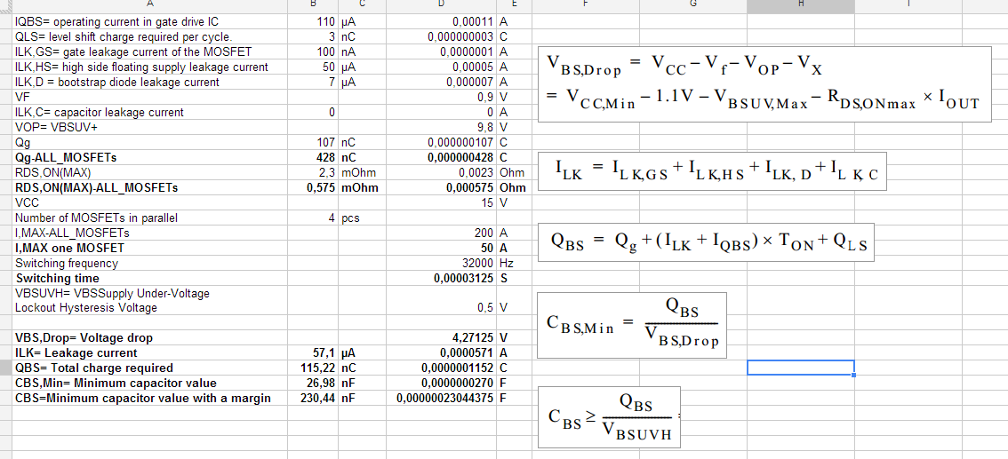

I have been using the examples in the AN-9052 to calculate the bootstrap capacitor value and it gives me a minimum capacitance of 101nF and using the margin it gives me 862nF.

I have attached a screenshot of my calculations with the formulas from AN-9052 page 3.
According to a capacitor calculator I found online, and using 15V and the leakage current to calculate the RC resistor value, a 230nF capacitor will discharge from 15V (optimistic because the capacitor will not hold this voltage due to forward voltage drop in the bootstrap diode) to 10V in 24.5ms so to answer my own question, NO, the 230nF capacitor will not hold the gate voltage within the safe area for 30ms...

If I keep the duty cycle at 99% (and use 32kHz) when the motor spins at lower speeds (max motor speed is 30.000rpm) the bootstrap capacitor will be recharged every 31.25µs. If I then use 4.7ohms gate resistor, which doubles as bootstrap resistor, a bootstrap capacitor of 1µF will recharge from 10V to 14.99V in just under 30µs. So I just need to make sure the capacitor is refreshed using the MCU to control the duty cycle at lower motor speeds or just settle with 99% duty cycle as a maximum.
