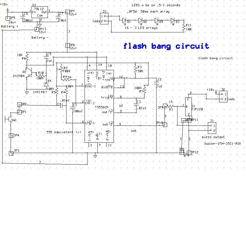

Sounds like a FLASH BANG grenade
Have a schematic somewhere for one.
will locate
a BASIC flash bang
here is a schematic that never got built so weather it works?
if wanting to just use batteries of low voltage then eliminate the voltage regulator.
A better unit could be built using a PIC but then you need programing.
about the only parts needed then are a PIC, a couple resistors, a transistor and lots of LEDs
No offense MrDEB, but your schematic is attrotious.
As for the Issue, I would use a 555, or 556 timer. I would also use a capacitor in place of a battery so that the "grenade" can not be thrown back after it has finished flashing. Using a special holder that would connect said grenade to a battery source would allow the capacitor to charge until it is thrown, at which point it would switch to the capacitor. I would use a 10,000uF capacitor. I have one that is rated for 16V and is only 2" long and 1" across. A constant current source would allow the LED to stay at a constant brightness as the capacitor discharges, and a simple comparator would cut off the capacitor once it's dead, and would also act as a switch to turn it on. I'll finish the schematic and post it later.

in what way is this schematic "atrocious" (you need to use a spell check for such big words - lol
The schematic was a suggestion. I would go for the PIC idea instead.
The posted schematic was a circuit that was talked about 2 years ago.
The capacitor idea is not bad but not into big capacitors seeing how you have LOTS of LEDs to fire.
