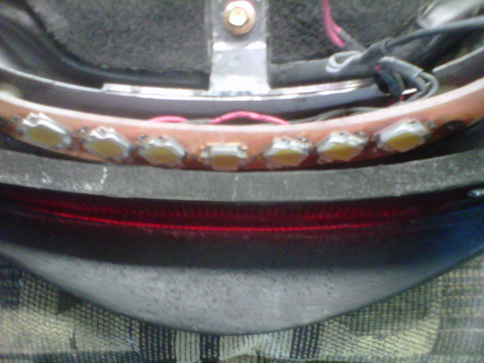

I am interested in dimming Led... I have one bank of 7
10W 900LM White/Warm White High Bright LED Light Lamp Chip DC 9-12V
I am supplying power 12v and step down to 10v. ....
I am trying to dim the Leds in order to use as running lights 10v and also as 12v brake lights.
One + power comes from the running light circuit, it is the input that needs to be step down from 12v to 10v in order to dim Leds
The other power is 12v coming from the brake light circuit. Full 12v led input.
The connector has one output from brake circuit 12v, and the other need to stepped down to 10v for dimmed led
I hope I have not made a mess of my explanation of my needs.
Thank you for all your time and effort, for any help.
Bob

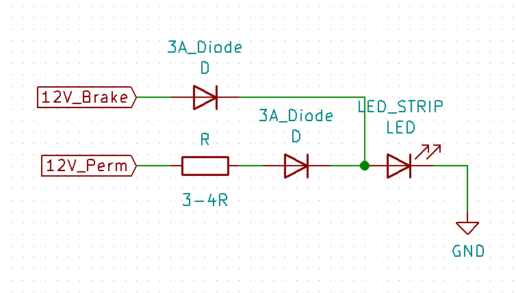

Your question has nothing to do with Zener diodes, but anyway... The simplest way to dim a string of LED's is by adding a series resistor. To determine the value of that resistor we would need to have the full specs on the LED. But based on the "10W" rating, try a 3.3 ohm 5 watt resistor.

If you were to use a voltage / current dropping device, the power you want to be removed from the LEDs has to be burned up as heat - this is inefficient and can be a pain to get rid of.
I did use a formula and it came up as 4.0 ohm 5 watt. Damn I was close.

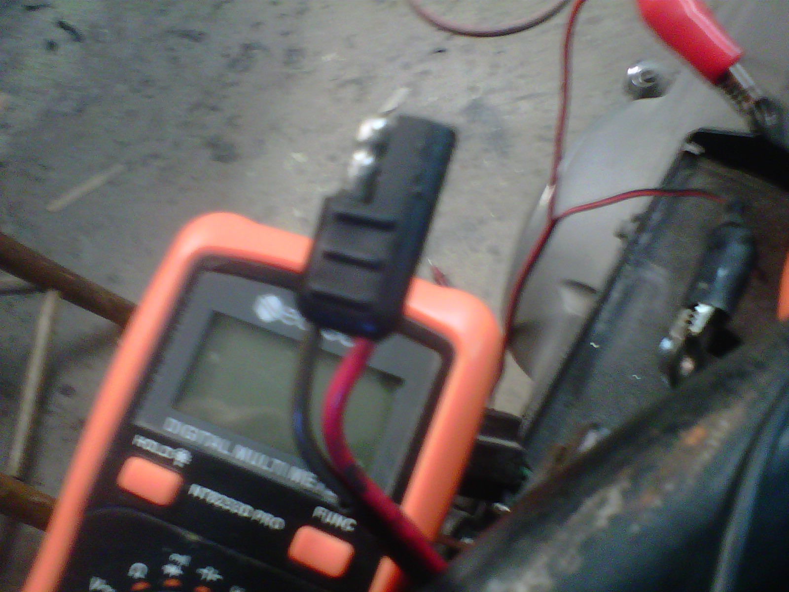

The power is supplied thru relays. Is there a need to use a diode to limit feed back ? Or just a precaution.
Both power input will have power at the same time. I guess I need to cancel/block. They need to be independent application. to Leds
When the leds are on, they are consent 10v dimmed. They are only brighter full 12v when brake circuit is applied.
Make sense ?
I had looked in to the type steep down. I need a one time simple ( cheap ) nonadjustable solution.
It all depends on whether you have a switched ground or switched positive to the LEDs from your brake circuit.
A diode is fine to prevent back feed - think of it as a one way valve.

To ground. Is there need to worry about heat ? at resistors.

10W at 12V is about 0.83A, it may be slightly higher as cars tend to run at 13.8V-14.8V.
Assume though 10W @ 12v so you'll be dropping 2v @ 0.83A which is 1.66W - it will get hot to the touch when running so I'd personally look at a small metal cased resistor which you could screw on to the chassis to act as a very large heatsink !
It is illegal to tamper with vehicle lighting in my country because many beginners make the lights too dim, too bright or the wrong color.
The drawing called, "Something like this" might feed 14.4V from the alternator through the diode producing 13.7V. Since you did not post details about the LEDs then they might have an absolute maximum voltage of 9V (to 12V) and blow up. LEDs are usually fed a limited current, not a voltage.
