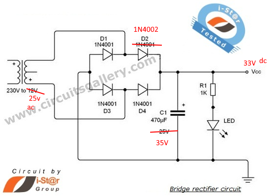

Here is a circuit that changes 25Vac to 33Vdc. Is this what you want?
I was planning to use the 24v transformer on an existing Gas(LP) hot air furnace and tap the 24v and convert to DC so I can hook up an arduino and create a propane gas leak sensor. Your schematic could work , but would have any affect on a furnace control board that uses 24v AC and I'm pretty sure it converts to DC on the board.

If the voltage drops from 30 to 5 then the current will increase 160mA in to 1000mA out.
I do not know how much current the computer board needs but less than 1A!. So the current from the 24Vac will be less than 160mA.

I would just use a full wave bridge on your AC supply to rectify it. Then add a buck converter as a simple economical solution affording 5 V at 1 Amp and you should never need that much.
