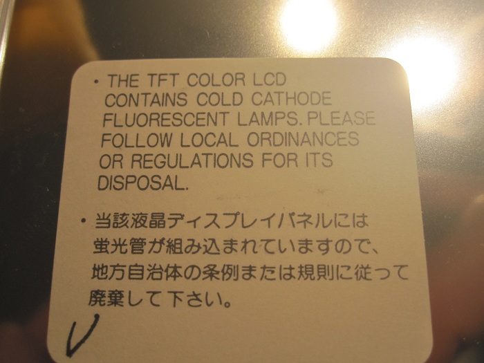

Hi, as I was hacking this laptop (basically just an euphemism for ripping it apart).

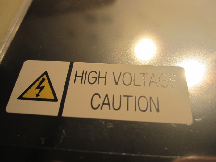

I saw this "High Voltage" sign on the back of the LCD. Can someone please explain to me what this is doing in a laptop?

Cold cathode = no filament. Florescent = a little mercury in a tube and a phosphor and you guesed it, a high voltage. About 300 V or so, I believe.
It's the backlight for the LCD screen. Without the light, the screen would be very dark.
New technology is LED backlit.
Transformer based, and fairly low current.
Edit: Post 556
They use an inverter. So as you hack away, note the backlight(s) and follow the wires. You should find the inverter power supply that drives them.
AC and give this a read.
