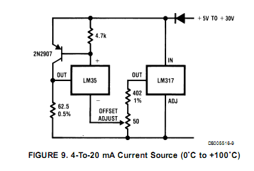

OK, here's what I need:
humidity sensor with HIH-4000 with current output 4-20mA
I mentioned temp sensor LM35 with current output 4-20mA and it's done with LM317 and it works well, so I mean somebody made something similar for humidity sensor HIH-4000, that's the reason for mentioning LM317...
thanks again ...
also forgot :), HIH-4000 have linear voltage output 0.958V - 4.026V for 0-100% RH humidity
Do you mean this LM35/LM317 App.??

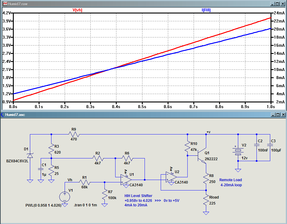

Does the 4mA to 20mA for the HIH, have to be referenced to 0V.?

Exactly that application for LM35/LM317!
HIH-4000 have linear voltage output from 0.958V for 0%RH and 4.026V for 100%RH.
ie: is the remote sensor resistor connected to ground.?
No, zero offset for HIH-4000 is 0.958V and the slope is 30.680mV/%RH.
I dont mean the HIH, I mean the remote equipment that 'reads' the 4mA to 20mA loop current.
ie: what is the application that the 4 to 20mA is driving into.?
PLC Unitronics Jazz, 4-20mA current input, 154ohm input imedance.
This would work , providing the guitar and V2I converter dont share the same power supply lines/common.

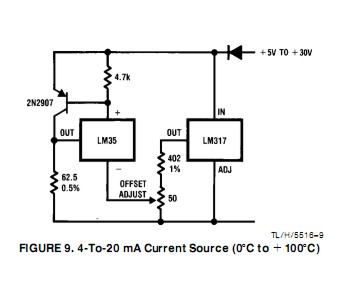

Also, maybe you have solution with LM317, like in PDF for LM35 and here's schematic: LM35 current outp&.jpg
HIH-4000 instead LM35?, but I couldn't find more details about this schematic and I made it and it works well for temperature.
It works great!!! :), thank you very very much.
I didn't have CA3240 (instead 2xCA3140) and I used TL072 for test and it works well!
Just one more question about calibration, I mean, how to set output current exactly from 4-20mA, can I replace 250ohm on emitter with trimmer to adjust output current?

Thats good news,
I would split the fixed 225R into say a 200R fixed and a 100R variable, in that way you will get a finer control of the current.
NOTE: its the 225R which sets the current, the 250R to the emitter is the 'loop resistance'

I've done that, but, at the end, I used 56ohm and 50ohm multiturn trimmer to get "real" value and also, I'm planning to go to meteo station to compare results with their RH sensors :)
One more thing, can you, please, tell me in which software you done simulation and can you send me file to try myself? I suppose it will help me to better understand whole circuit.

Download LTspice, free, from Linear Technology also join the Yahoo LTspice users group.
