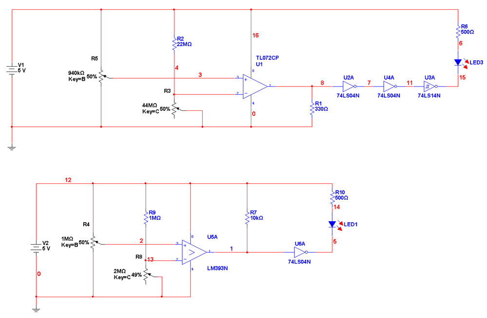

I thought it would be nice to have my bathroom fan on a humidity switch...
Also need it for something else too...
I've seen it mentioned here a few times, that a resistor with the paint scraped off will vary with the humidity level...
I haven't seen it implented so I thought I would give it a try...
I tried it with a TL072 since I had one handy, might try it with a 741 as well since I have some around here..
The first circuit shown works great... except that the TL072 doesnt swing to GND... it's low position is 1.6v... hence the funny output series of invertors...
The second circuit I did not test, it should swing to GND ...
So,.... how well does it work?
It seems to be able to sense my finger from about 5 mm distance... or if I blow on it from about 30cm...
Thought it might be heat... so I tried wet paper near it, that works too...
It turns on and off very quickly... on time is too short to count and off time is perhaps a few seconds at the most...
R3 and R8 I used to model the naked resistor...

One can only imagine this is a meat-drying box? Infrared lamps similar to those used for raising chicks work well, and a small fan (space-heaters set to minimum work). More interested in how calibrating the 'resistor' sensor worked out, any photos of your resistor might encourage others to try building such a cheap sensor if it did work.
hey~~
I was thinking some might be intresting in the resistor humidity sensor as well... as I have seen it mentioned in a few threads but have not seen it in application...
I will be going out to pick up some parts later today if I make the time, otherwise Wednesday... I'll pick up an LM393 and test it ...
My goal was to have a set humidity point at which it triggers... not so much a sensor as a switch...

I have never tried building a capacitive humidity sensor, only a level-sensing one for rainwater tanks. So what kind of surface area and gap does one need? I am also thinking about dust messing with the dielectric properties in the gap, so long-term feasability is probably an issue? Most of all, protect the sensor, but in some way so as not to require airflow to still get a reading. I've just gotten some spare 5W ceramic resistors, so am very keen to un-cover how to 'modify' them and stand a chance of doing some kind of switching.
I like the idea of using a resistor with the coating removed as an RH sensor. It would be interesting to see how linear the change is in relation to the RH.
