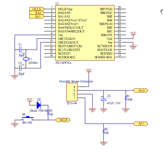

Hi , it seem my code suceeded build but LCD did not display anything need help...

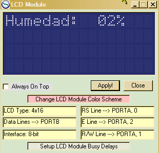

The code works OK in the Oshonsoft simulator, is your project wiring correct.?
Many thanks, will look thru the d/s, get back to you.

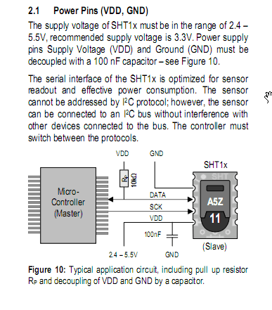

From the program, it looks as though the project shares the PORTB with the LCD and humidity sensor, so that where the problem could be when using a different sensor.
EDIT:
A quick look at the d/s, shows that the SHT is I2C connection and the HND is analog they are not compatible.
