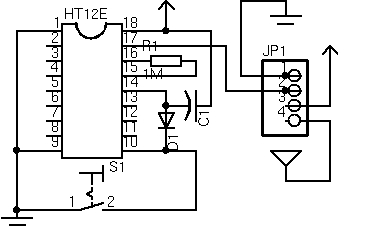

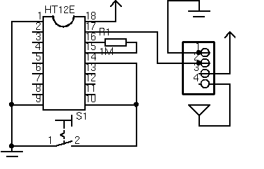

Ive seen other people asking about why the output of the HT12D latches. I never came across this problem until now, and its driving me nuts! It is a totally sporatic thing. When it latches, I can sometimes press the transmit button on the HT12E/transmitter and the output will go from low to high (active to inactive).
Can anybody shed some light on the subject for me?
Ive discovered why the HT12D is latching. As you see on my schematic, pin 10 and pin 14 are activated by closing the switch. Pin 10 is the data pin, and pin 14 is the TE (transmit enable) pin.
If pin 14 is held to ground, and not activated only when the switch is closed, everything works smoothly. When it is activated at the same time as pin 10, thats when things get messy. I would keep pin 14 grounded and everything would work fine, but the problem with that is when TE is enabled, it sends a signal to the RF module that it is attatched to continously, wasting battery power. The idea with the switch is that it only transmits when the switch is closed.
Anybody have any ideas as to how to do this?

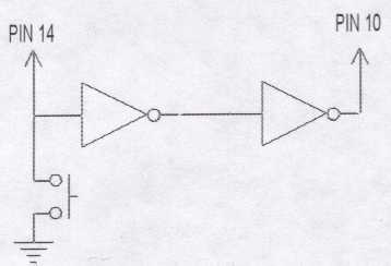

Yes thats right russ. Im glad that I made myself clear enough. Wasn't sure if i did.
Since I don't know much about digital electronics, what are inverters? Can I do it with two transistors?
I figured Id give one more shot at trying to solve the problem my way and i did!!
I realized that it doesnt matter which pin gets activated first, the data or TE. In fact on the datasheet, it shows all of the data pins being a SPST switch, and the TE being a pushbutton switch, so that when the TE pin is activated, the data pins have already been activated.
The capacitor has to charge up before TE can be activated.
So what it basically comes down to is which will be cheaper and smaller?
BTW, I cant make the delay on any of the data pins because the TE pin will be activated right away, but the data pin might take too long to activate, and the signal won't get through. Also, I only have to do this on one pin, as opposed to doing it on each data pin that i use.

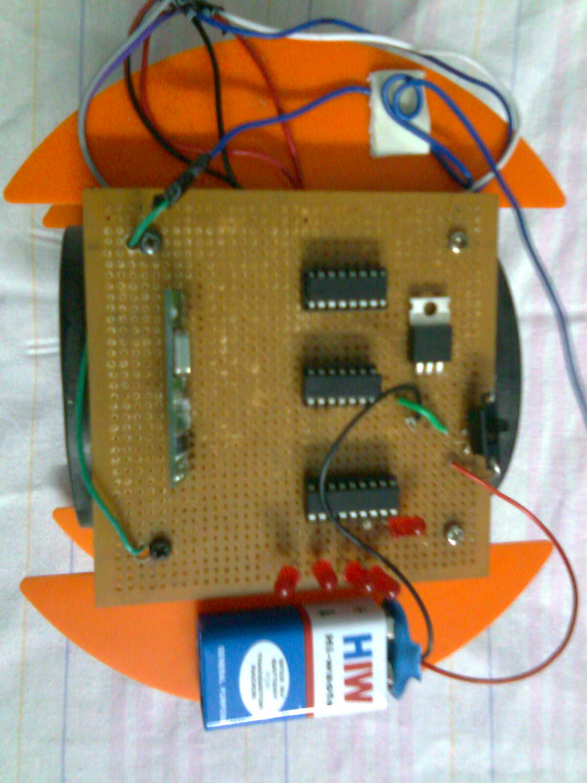

hello,
can anyone help me...
i've recently finished my project titled "RF remote controlled robot".
actually the project is dc motor control using RF module and i've fitted wheels to the motors so it works as robot.
i'm attaching the abstract,circuit diagram
remote control transmitter part consists of 4 switches,based on which the controls are sent to the motor to rotate it in desired directions..
in my project i've pulled the TE(14 pin) of HT12E to gnd directly.....
now,my pblm is when i give the following commands at the switches the following is the result expected
0101-forward
1010-bckward
0001-left turn
0100-right turn
1001-left spin
0110-right spin
0010-left back
1000-right back
all these movements are working perfectly well....but only after some delay,
that is when i switch on the supply and press any switch the robot starts rotating in one particular direction and does not stop untill i manually stop it by switching off the power supply (even though i remove my finger by just touching the switch).....same is the case with any switch for abt 3-4 min...
after i manually stop the robot several times...(in abt 3-4 min) everything will be fine
soon after i touch a switch and leave the robot stops and the output is perfect for the above mentioned commands
i dont understand why there is this start up pblm?
can anyone pls help me?
