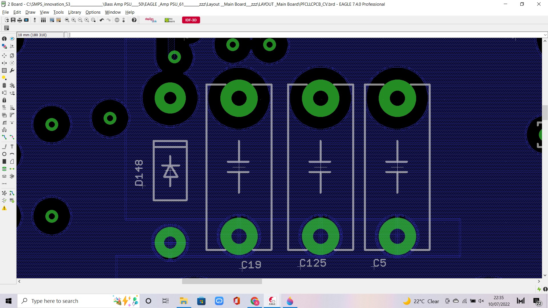

How will i solder capacitor without thermal relief?
Flyback

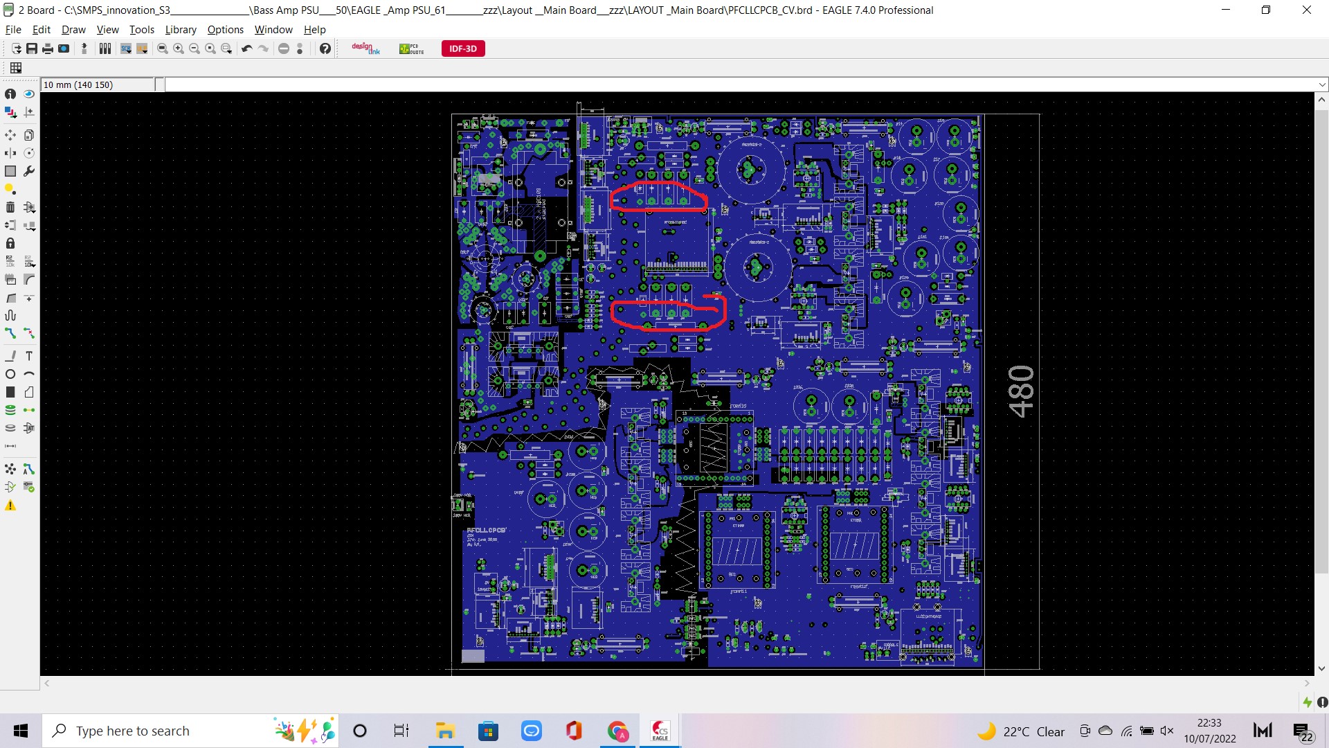

I have done a 4 layer board with 1 oz copper, 1.6mm thickness. (2000W PFC’d LLC)
There are six ECWFG2J105J film caps on it. Unfortunately I forgot to put thermal reliefs on the Layer 2 of this capacitor’s ground pin. (I remembered it for the other three layers)
Pictures as attached...(and gerbers as attached)
ECWFG2J105J datasheet:
https://industrial.panasonic.com/cdbs/www-data/pdf/RDL0000/RDL0000C245.pdf
I haven’t got the boards yet. When they arrive, will it be possible to solder these capacitors on? What is the cheapest “local heating” instrument that you can buy to heat this pin as I solder it? Some sort of mini hot-air gun sounds good?

Just get a higher power iron or a really massive tip. It wouldn't be that difficult.
Thanks, i have a 60w plug in iron and a 30w plug in iron, they are both not temp regulated.

For a start, don't mess about with extractor fans - you're just wasting money you haven't got. Use the money on buying a decent soldering temperature controlled iron, and you should get very little smoke anyway - plus you'll actually be able to solder things.
I would always recommend Antex irons, I've been using them for decades - they are extremely reliable, work well, and bits seem to last for ever.
I would suggest this for just an iron, with built-in temperature control:
I have the older version of this at home, with a screwdriver adjustment for temperature, I've been using it well over 30 years, and never had to replace the bit yet.
For a soldering station, this one:
I got this one for my boss at work a couple of years ago now, mine at work (again) is the older model - it was here when I started 5 years ago, I get through more than 0.5Kg of solder a year with it, and again I've never had to change the bit.
If you want to spend more, they do digital display versions as well.
Cheap crappy soldering stations are cheap for good reason - prior to ordering my boss the Antex, he'd been using cheap soldering stations from CPC, and they only lasted about a year each time.
