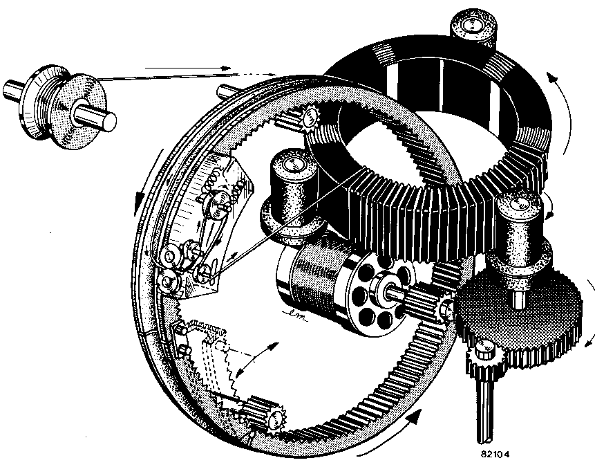

Not to do with formulae, but more to to with winding. I've always been puzzled how Toroids can be wound by a machine?
Camerart.
I've always been puzzled how Toroids can be wound by a machine? Camerart.
Me too.
That's clever. I will have to study it more to see why the spool winds one way while the ring go the other way.
Camerart
To be honest I never managed to understand it 100% and I always wonder how is it used for mass production. I guess that setting the whole thing for the the next toroid should be not simple. Just guessing...

I've only seen one real life toroid winding machine in my life. It's quite a complicated machine.
It winds the turns around the core as it rotates the core around, and the bumpers that hold the core are cushioned and they turn to make the core rotate. It's quite amazing to watch, maybe there is a video somewhere on the web.
To do it by hand, a 'shuttle' is used. First the total length of the wire is computed, knowing the core surface circumference and taking into account how that changes as the turns are added. This length of wire is then wound onto a small bobbin that can fit through the center of the toroid. The turns are then applied by pushing the bobbin through the center of the core repeatedly until the correct number of turns are applied.
A layer of tape would then be applied, then the next winding.
Bifilar windings are done the same way except two wire lengths are cut and wound onto the bobbin.
The bobbin is usually referred to as the "shuttle".
