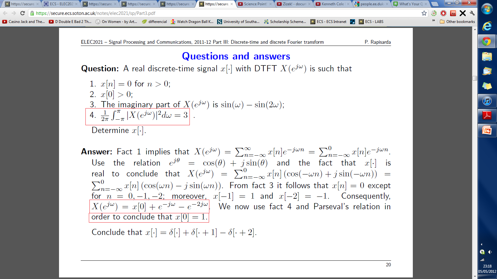

Hey guys, I don't quite get how my lecturer got the following result:
How did he get X[0]=1? I am actually not sure how to compute |X(e^jw|^2, do the "|" symbol mean modulus?
Thanks!
-Question Attached.
Everything between the "| |" symbols indicate you use the absolute value.
