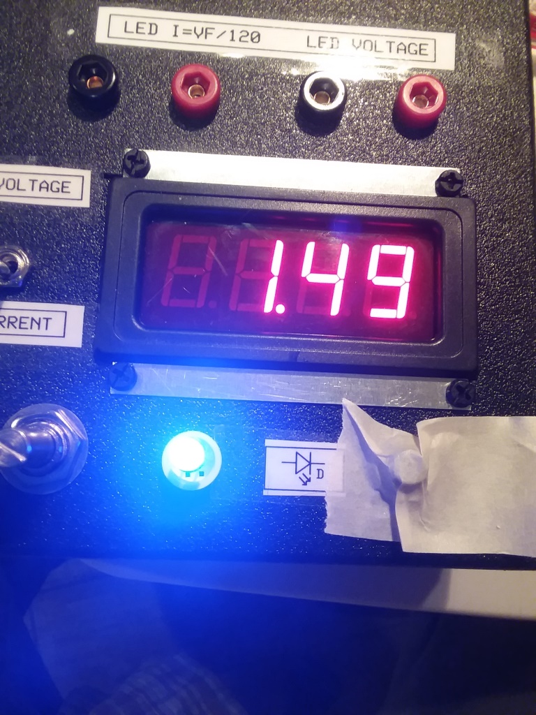

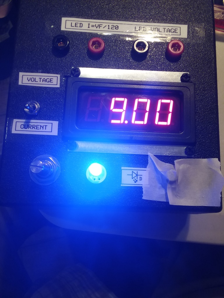

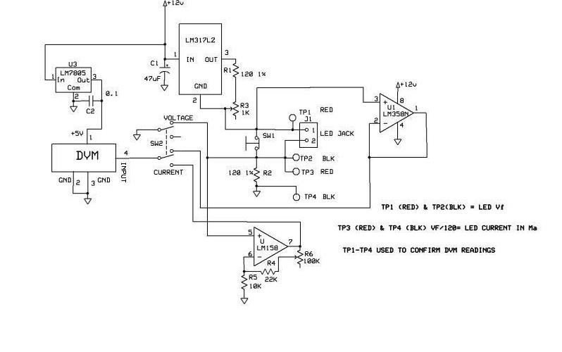

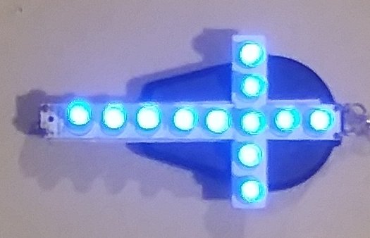

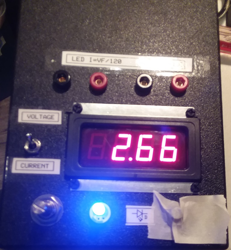

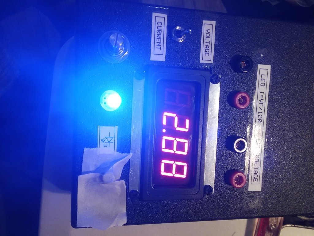

I agree that trying to match LED's can be a problem. I have been doing projects for a long time. I can remember when blue and white LED's were not avaiable in the consumer market place. I have been able to connect LED's in parallel on a number of projects. I match the forward voltage within about 50mV at the desired current. The select the current limiting resistor depending on the # of LED's and the supply voltage.
I am uploading a schematic of a LED matcher I recently built. In the schematic there is a pot that I adjust the desired current. This pot is a multi turn 1K. The momentary push button has some scotch tape to hold it down while I was taking the pictures. The push button was added as a safety feature. The black & red tip jacks above the display were added to confirm aqccuracy of the display.

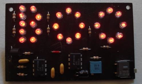

The pictures show the current of 1.49mA and a Vf of 2.66 and a current of 9mA and a Vf of 2.88V. I am also posting a picture of a BOO badge that flashes and aq picture of a cross that has 12 blue LED's in parallel.
That is one fancy-*** LED tester! Much cooler than mine. But mine does have 4X AA batteries for the option of portability and I'm guessing yours doesn't, so my tester's performance can be outstanding in the field.
