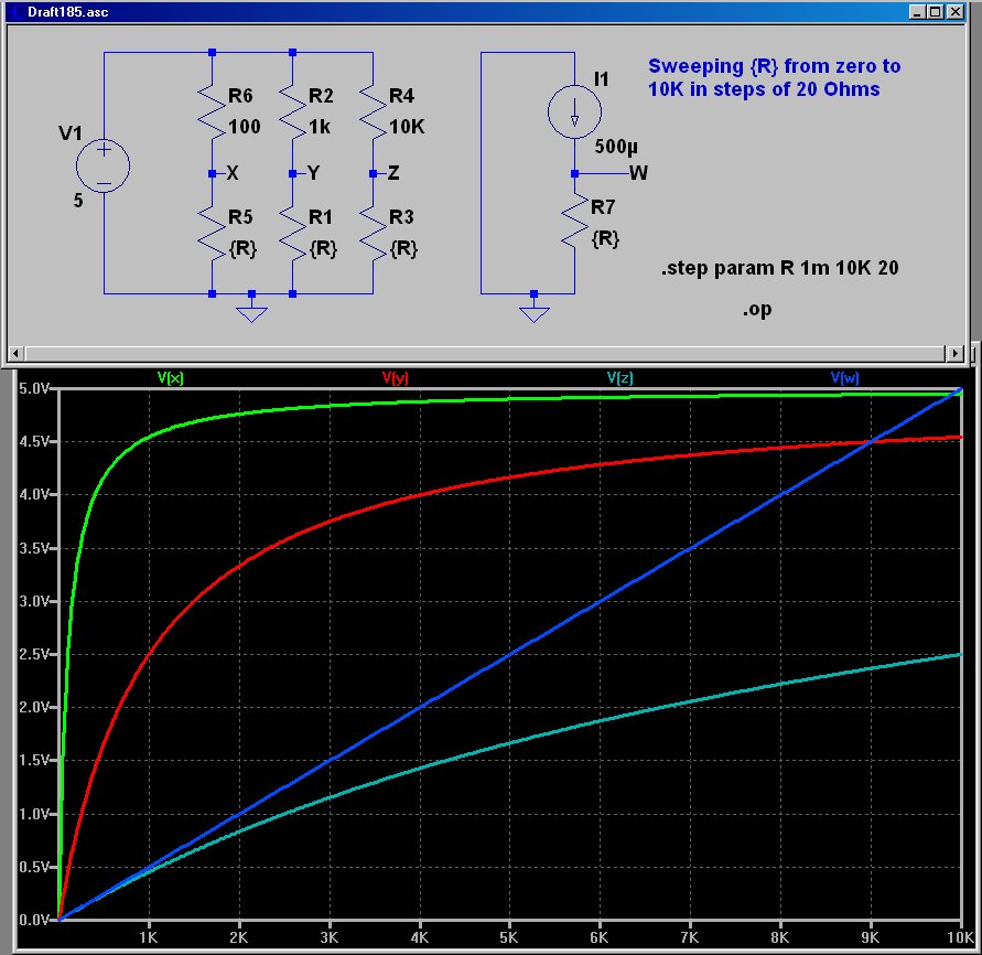

This might be a very basic question. I am wondering if there is any way to use a 2 terminal rheostat as a voltage divider. I am trying to use AD5174 as a 5V DC divider. AD has other chips that are digital potentiometers, but most of them are of very high tolerance except AD5292, but its not designed to work at its max efficienfy for voltages below 15V. AD5174 is very good in it resistance repeatability and tolerance, but it was only a rheostat.
Any suggestions?
thanks
Put another resistor in Series with it, Than take off your output between the Two.
That will affect the linearity, however. Look at the attached sim, where a 10K variable resistor is put in series with 100, 1K and 10K. The voltage at X, Y and Z is plotted vs the resistance R (the variable resistor). Note that the only way to get a linear V vs R (see V(W), dark blue trace) is to drive the variable resistance with a constant current source.

If the voltage divider is looking into 10K ohms, then, yes, a 100K voltage divider would have a loading problem without a buffer. But, so would a 10K voltage divider for that matter.
Maybe your resistor tolerance issue is more a problem that the part you are using is loading the divider's voltage down because your part is draining some of the current from it.
