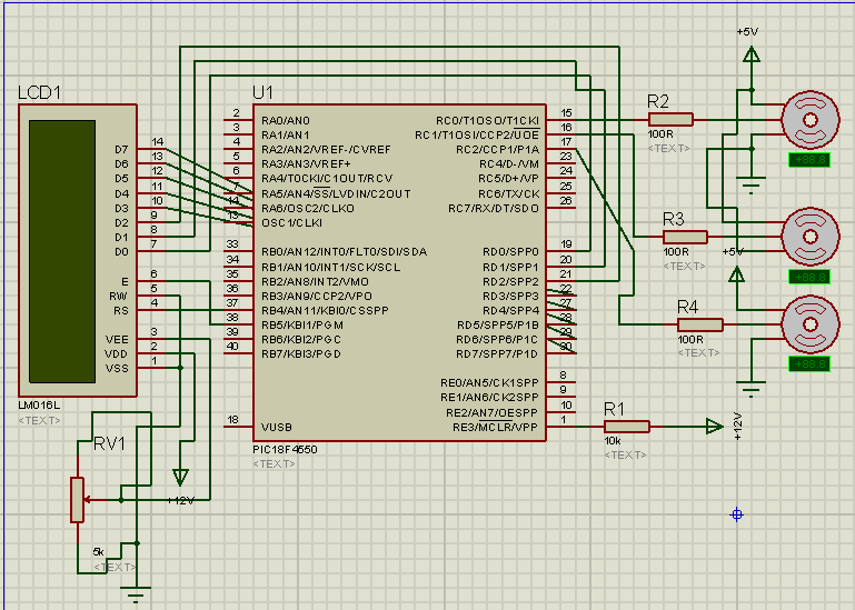

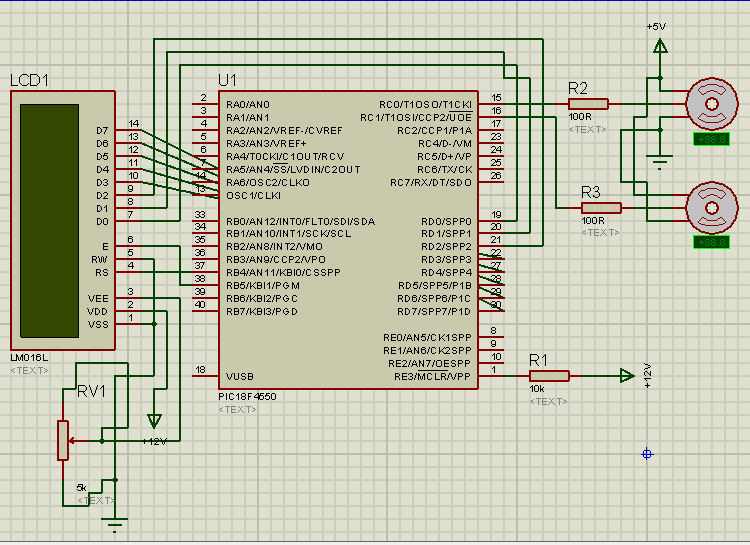

here i have attach the LCD and servo motor on circuit. But i do not know where to put the IR set... how to upload attachment file? easier to put whole design...
sorry i forgot the servo motor just two...

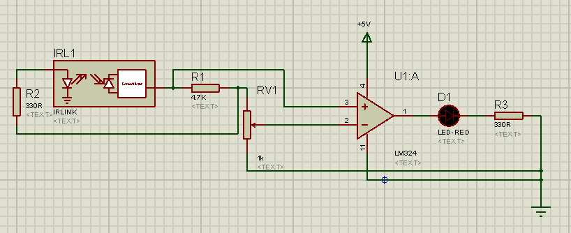

here is IR set, it need LM324... i do not know what is that... :
for this i see LED use at the Output pin maybe to detect if got object or not. if i want to use servo motor with IR should i replace the LED with servo motor or let the LED be? where should i connect the servo motor to make it work?

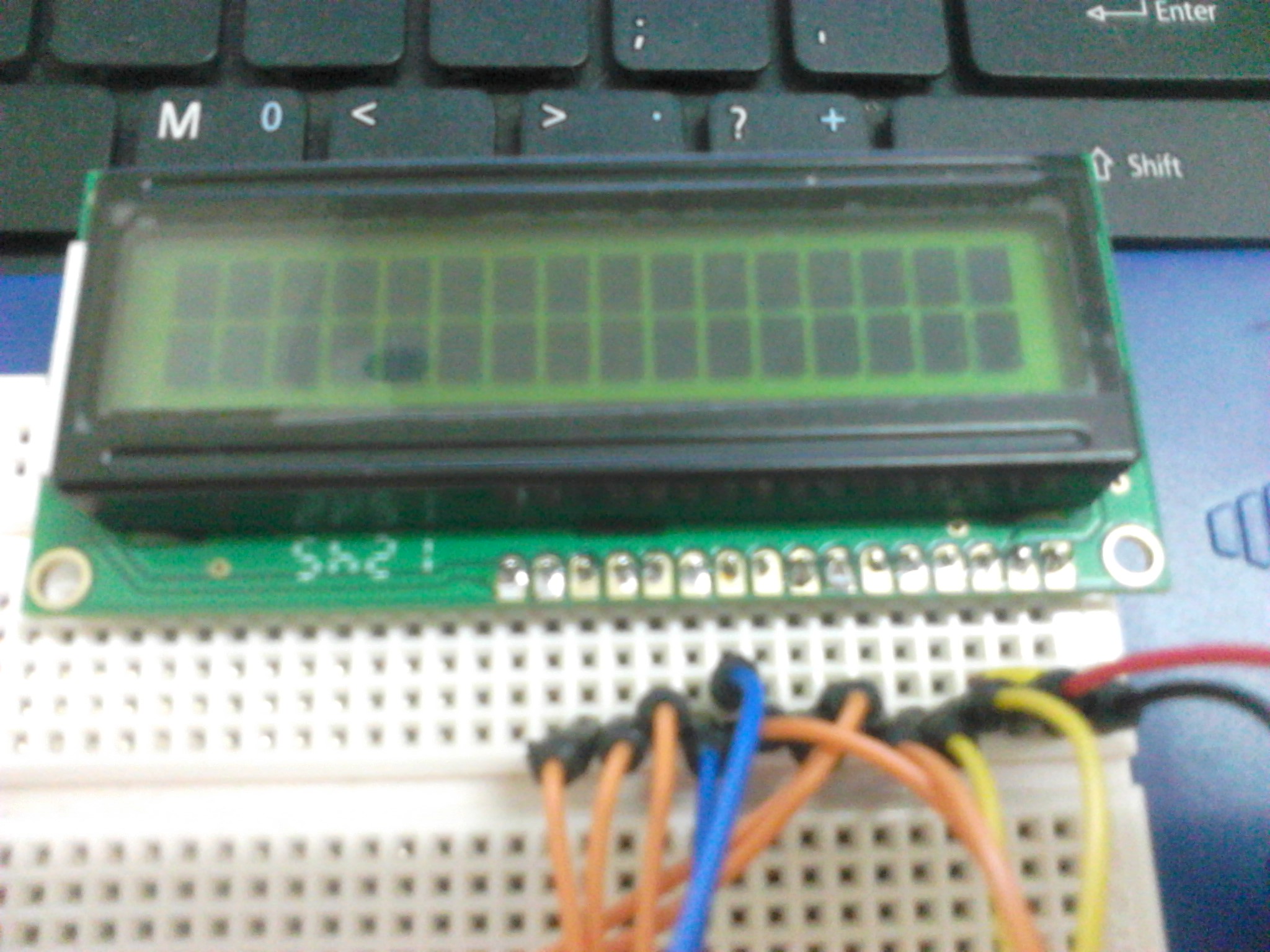

hi, i have done simulation on this circuit after couple month of research... but when i want to make hardware, the LCD give me 2 row of Black Box.
the connection almost same as this:Untitled1.jpg
I not using variable resistor instead i connect to ground vss+vee.
here how it look like:DSC_0078.jpg

how to fix this problem?
You MUST wait 15mS before you can initialize the LCD..
Try this...
void lcd_ini()
     Delay_Ms(15);
     lcdcmd(0x38);
     Delay_Ms(5);
     lcdcmd(0x38);
     Delay_Ms(5);
     lcdcmd(0x0c);
     lcdcmd(0x01);
     lcdcmd(0x06);
     lcdcmd(0x80);
should i replace
 while(1)
        Delay_ms(100);
        Lcd_Init();
with
while(1)
        Delay_ms(100);
        lcd_ini();
when recheck my main() i not using function lcd_ini()
Oh mow I see your problem..... You can't initialise the LCD more than once... Place the LCDinit() BEFORE the while(1) statement
so if i put the lcd initialize before while(1) then the command to change the text or command in the while(1) what will happen?
thank you very much for the delay before initialize... it not work at first then i test couple of time it suddenly work...
