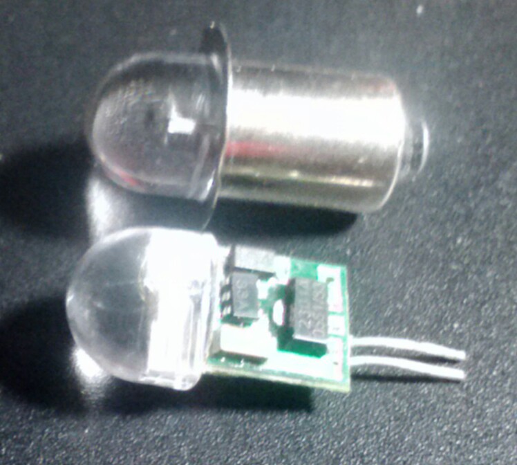

The LED bulbs that I have worked on have a PWM switching power supply that takes the battery voltage and changes it (boost or buck) to make the correct current for the LEDs. The higher end bulbs have a temperature control so the LED does not get too hot. I have some bulbs that have a 6 pin or 8 pin microcontroller built in that allows for several modes of operation. Some have a time-out timer that shuts off the light. Some even include the battery charger.
The picture is of a bulb packed with electronics.

First picture is of three LED flashlight bulbs. Each has a switching power supply inside. The bulb with three LEDs; yes the LEDs are in parallel. There are tightly sorted! The black dot is the inductor for the switcher. They come in white, red, green, yellow etc. The advantage of a current switching power supply is that the Vf of the LED is not important.
The last picture is a bulb that works from 2 volts to 10 volts. My memory says that they work to 20 volts but they were never sold that way. The PCB shows the IC and transistor. The other side the board has a resistor, inductor and cap. This bulb is pretty simple. I have some very complicated bulbs. The one bulb has no case so could work on it.

my assumption is that there is some kind of protection circuit in side the led module which is shutting off the power to led wen i am connecting the dc source. but why it is doing this ??
now just tell me how to wire this led module to make it light up. i delivered different voltages frm 1.2v to 5 v to this led module but it is not lighting up continuously just flashing for a second at the time of connection.
