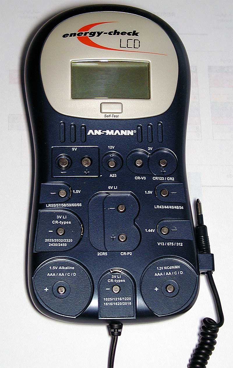

There is only one portable high quality battery tester with load, out there.
And this is the " Ansmann Energy check "
Its not cheap, but it is second to none.
I just love it ..
