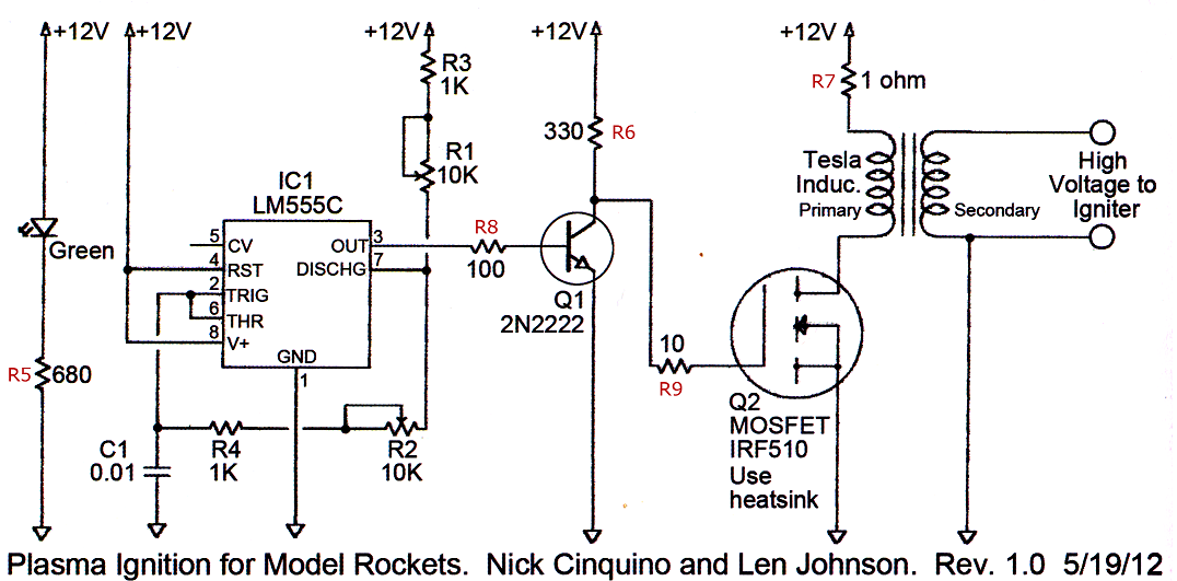

I'm an electronics neophyte, looking for a transformer, to generate a spot of plasma at the end of two leads. In particular, I am trying to build the circuit here:
This circuit is published in a couple of magazines. The last component I need to finish the circuit is the transformer that converts 12vDC to “a few kv” at kilohertz frequencies. The author calls the transformer a Tesla Inductor, and suggests obtaining one by pulling one out of a furnace ignition system. I have had no luck finding a used furnace ignition system that has a transformer.
I would buy a transformer new, but neither the schematic nor the articles detail the specifications of the transformer, and I do not know enough to infer them.
I have figured out that I need a low current, high voltage transformer. This may be known as an ignition, or spark, transformer. I think I need to know at least the impedance and operating frequency, as I have inferred the input voltage (12) and input current (10 ma) from the 555 timer. Some vendors seem to want me to specify windings, winding ratios, resistance etc.

Perhaps a standard car ignition coil would work. I would start with a higher value resistor for R7 (say 10 ohms) and work down from there until you have the spark you need.
Thanks guys, 'Ill try that. I may have a 1959 Triumph coil in the garage. But can you give any guidance on what characteristics of a car ignition coil make it suitable? In terms of transformer parameters? And what should I use as a power source? I was thinking D cells. Would a 12v car battery fry my circuit?
An automotive ignition coil wont run at a few kilohertz though. Maybe a few hundred at best.
If you are trying to get a good high frequency high voltage output a common flyback transformer from a old CRT type TV or computer monitor is what you would be wanting. Those can easily be ran at frequencies in the 20 - 50 KHZ range which will give you a nice smooth quiet arc.
For a 12 volt primary you may only need 3 - 5 turns of wire on the open half of the core which is a easy hand wind operation.
