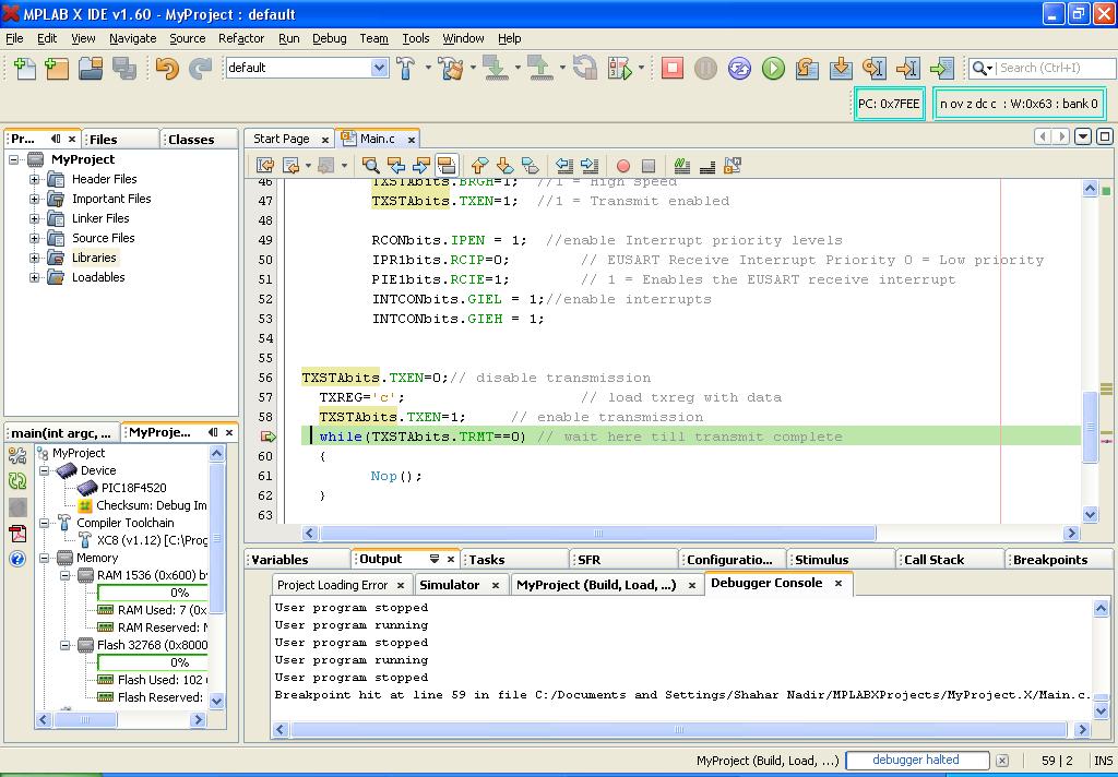

I followed your description, then I set the project into debug mode.
However, I don't see any UART window (although I enabled it as you said).
How do you make it appear?

This is the UART IO configuration as you indicated:
However, as you can see below, there's no UART window / tab:
Any idea what's wrong?

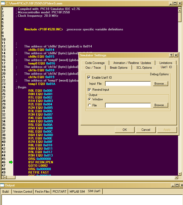

Click Debugger/Settings /UART I/O
You should see as this image.
The Window, is the output Window.
E.
hi electro,
Its present in MPLAB v7.60 and v8.83
E.

I ran a code in which it sends Chars to PC (from PIC) and the UART1 window appeared!
Thanks a lot guys!

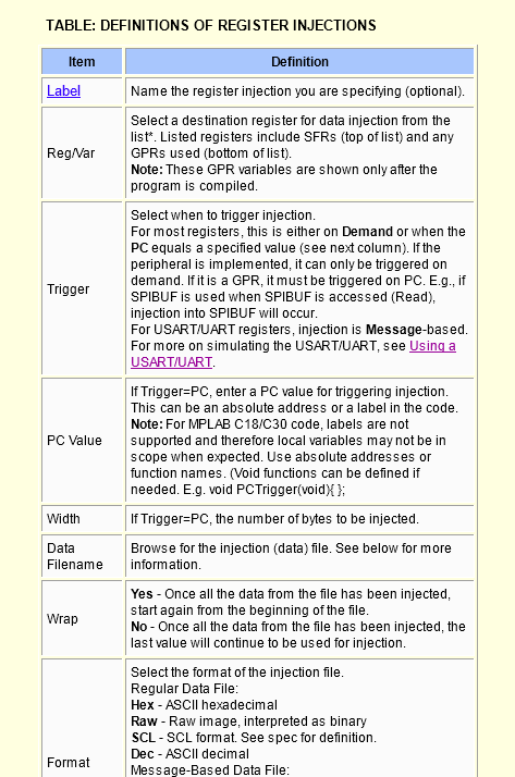

You have two options option 1 send the file once... Or if you click the rewind button, it'll be a continuous loop..
You can also use register injection.... Any given time you can inject a value into the UART.. Read the MPLAB SIM help file... Search for UART I/O ... Then read register injection.
Thanks Ian.

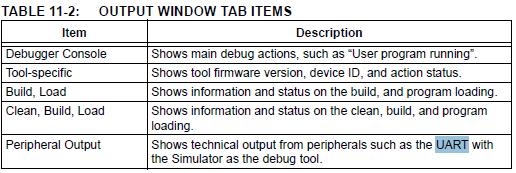

The MPLAB X Manual is VERY problematic, it actually explains nothing.
For example.
UART word appears only once.
Injection register does not appear there at all..
I'll try looking for that elsewhere
