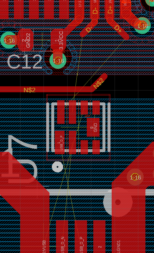

I was suggested to use EMI2121 for EMI/ESD protection of my circuit by Microchip while interfacing with their MCP2210 interface controller. Searched online and have seen this being used in many applications but didnt come across one board design so far. EMI2121 package seems pretty good, but for me, I was not able to figure out how to route the differential USB pair to this package's 1 (D+) and 2(D-) pins without using vias and on the other hand they suggest not to use any vias for USB data lines while using similar length traces. Wish they designed this package in a more board designer friendly way by having Vbus, D- and D+ on one side and corresponding outputs on the other side.
Any suggestions?
thanks

D1 and D2 can be switched into the chip (USB D1 can go into Input 2- on the chip, and that becomes output 2 on the chip. Both data lines are the same on that EMI suppression chip.
Thanks for your reply gophert. My initial thinking was that way, but then looking at online resources related to this chip, I was doubtful. Looking at the pin description and design resources on ON semi website, they are always swapped to actual USB pinout. The pin description specifically says + and - in and outs for the IC. Contacted semi and explained them the issue clearly and was told will get back to me after talking to their engineering team. Will followup with them today.

Look at the chip schematic. Both the same.
Followed gophert's suggestion and routed it by swapping the pins. Confirmed with OnSemi as well where they suggested to do the same.
