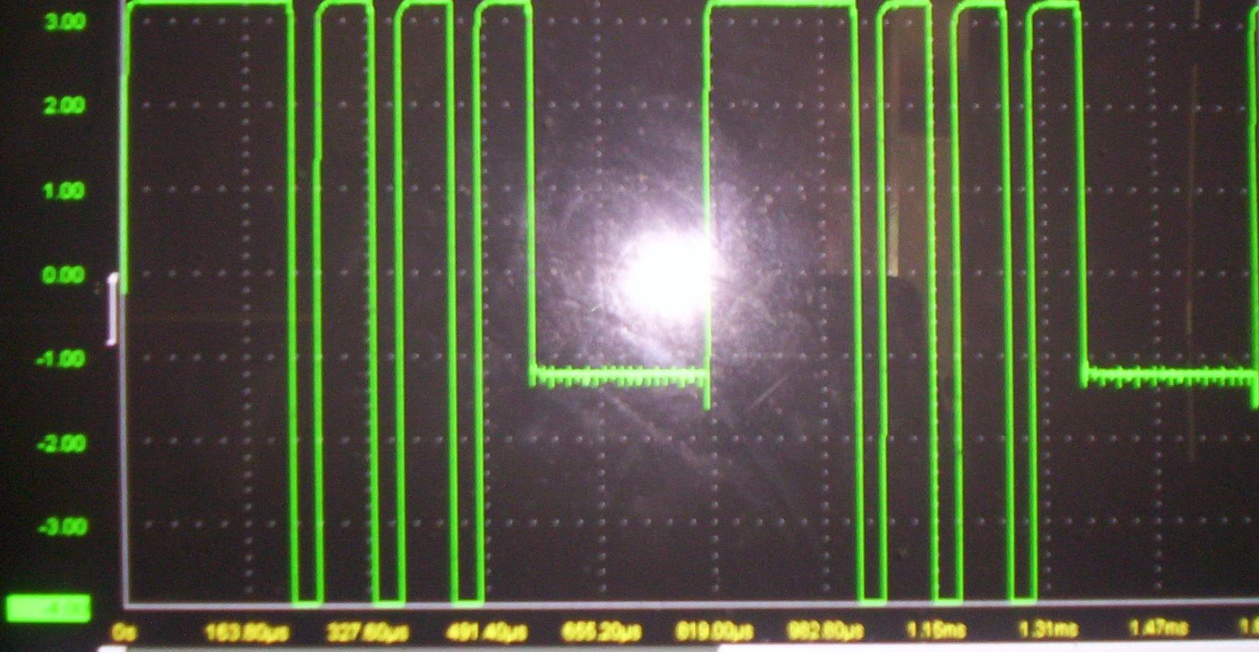

I have just pulled most of my hair out & setup an old PC Data Acquisition card in an old computer, it has an oscilloscope function etc but with no instructions--secondhand.
I have hooked up a circuit to read the frequency of the pulses to test things out, after much playing around i have what seems to be a good reading on the Monitor?
Is this ok for a reading of the frequency of a circuit?
Now i need to learn how to read this, can somebody please help me out.
I have attached a picture i have taken of the reading, it is a little out of focus.
Far Left verticle column of numbers is Voltage.
The time readings are a bit hard to read on the bottom but from left to right read:
0s 163.80us 327.60us 491.40us 655.20us 819.00us 982.80us 1.15ms 1.31ms 1.47ms 1.64ms.
I am not sure how to work out the frequency of this circuit or how many us or ms in a second etc--AARRGGGHHH!!
Not sure even if i have the settings right to do this?
The pulses vary so what do you call this type of Signal?
Also on the reading on the Horizontal lines --just below centre--some are a little fuzzy, is this just some sort of electrical interference?
Thank You

Ok, i'll give it a shot:
It takes 819.00us to complete one cycle, that is .000819sec
So if i get 1 divided by .000819= 1221 Hz
Is this correct? Or do i have no idea?

Looks like a reasonable waveform, but not knowing what the signal should look like I cant really comment.
Not really, see my comments further down the page.
There are 1,000,000 uS in one second and 1,000mS in one second.
Just the same as there are 1,000,000 micro anything, or 1,000 milli anything in a whole one.:)
It is difficult to assign a frequency to such a signal as it will have components at many frequencies.
If the waveform were a regular pattern, you could measure the period of one cycle of that pattern, then you can calculate the frequency by taking the reciprocal of the period.
eg if the period of the waveform is 20mS (0.02seconds), then the frequency is 50hz, (1/0.02).
At a quick look, there seems to be narrow pulses and wide pulses, again not knowing the source of the signal, it is difficult to say, but it looks like a form of Pulse Width Modulated signal.
Not necessarily interference, as in an unwanted external signal. It could be that the voltage is varying a little bit, or there is some noise on the signal.
A digital oscilloscope can only display the voltage in a discrete number of steps, so as the signal goes above or below one of the step values, so the trace will jump up and down as you see on your trace.
That's right, and it is quite simple if you stop thinking that it is complicated.
Frequency is cycles per second. That's cycles/second. That's number of cycles divided by time in seconds, and that is exactly what you did, 1 cycle divided by .000819 second.:D
However, you have more than 1 frequency producing the attached display.
That's more or less a square wave. At least it's closer to a square wave than it is to a sine or triangle wave. :) Without knowing what circuit you hooked up it's really quite impossible to tell you whether that's a reasonable reading for what the circuit is supposed to be doing, but it looks like you're definitely getting some kind of reading from it. That's a start.
There are a thousand ms (milliseconds) in a second. There are a billion ns (nanoseconds) in a second. There's a list of them and more information on the Wikipedia page on SI scale prefixes: https://en.wikipedia.org/wiki/SI_prefix
The signal looks more like logic than anything else (to me; maybe someone with more experience can recognize what it actually might be). I wouldn't worry too much about its frequency, but in general to get the frequency you measure from, say, one peak of a sine wave to the next peak, and how many time that will fit into one second is the frequency. Say you have a sine wave. Measure from one peak to the next. Say you find that there is 2ms from the first peak to the second. 2ms is 2 milliseconds, or 2 thousandths of a second, so that happens 500 times in one second, so the frequency is 500Hz. For a square wave you can measure from one rising edge to the next rising edge.
Correct!
But with reservations.
The waveform does appear to repeat, so you could say that the "repetition frequency" is 1221hz, but be aware that this is a complex waveform, so there are many frequencies within the waveform.
You did not say what the source of the input signal is.??
The period of 'A' is about 200uSec
The period of 'B' is about 100uSec
The period of 'C' is three bursts of 'B'
'E' is the sequence repeating..

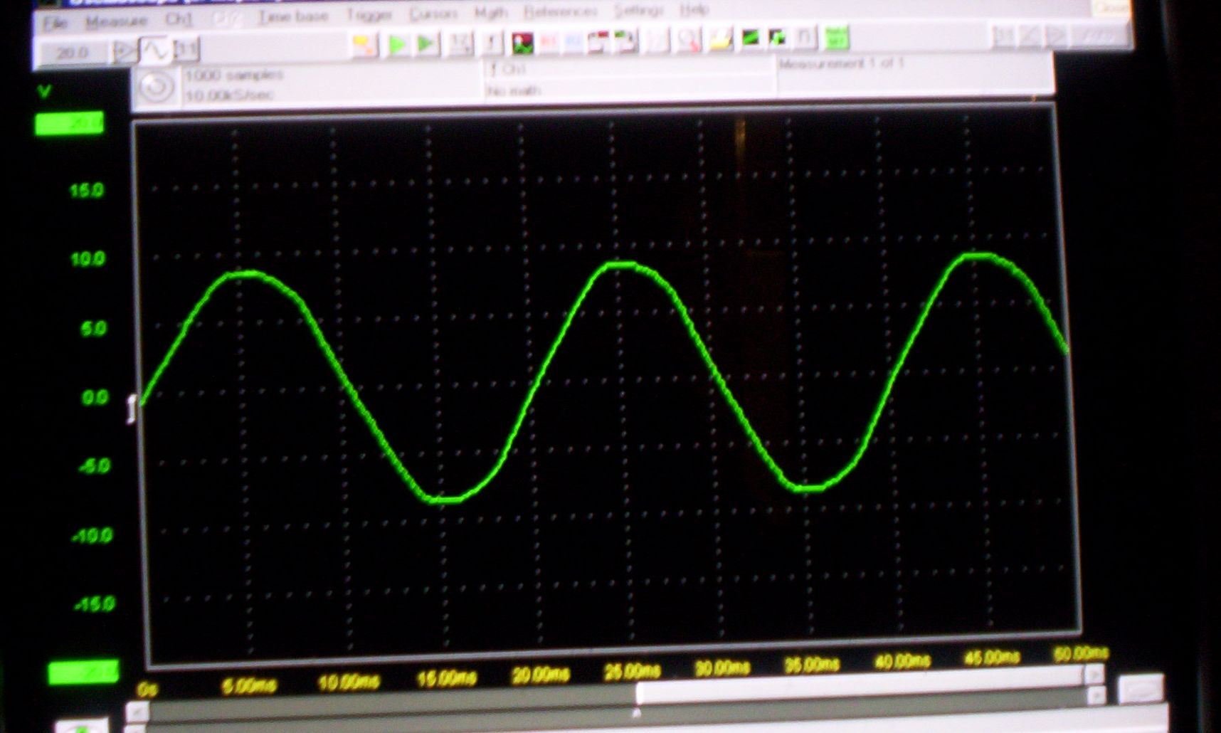

I set it up & fumbled around on the O-scope & have attached the results.
It's a bit out of focus again, left hand verticle column is in 5.0V increments & time left to right is in 5ms steps.
I set the input voltage at 6.0v with the multimeter so do i multiply this by 1.4 to get peak values, the scope is at 8.4v?
Thought there may have been a typing error on the previous post?
For the time settings i went 1 divided by 50Hz= .02/sec = 20ms if i have it right, it seems to be ok on the O-scope.

The Xaxis looks OK, 1/50 =.02 sec...
I cant read the Y axis scale.
Usually a DVM reads the rms value of a sinusiod, that is Vpeak * 0.707
So the 6Vrms of the meter should translate to 6 *1.4 =8.4Vpk or 16.8V pk to pk.
When you take your photo's, do you have a 'macro' focus on the camera.?
If not move further away from the PC screen.
Google for: Screen Hunter freeware its a program that enables you to take a screen shot of the PC screen or just a rectangular area.
The shot can be saved as a bmp or jpg [jpg is a smaller file]
Its possible to get good images from the screen using ScreenHunter.
You can then edit them using a photo edit program.
Give it a try and repost the image....:)

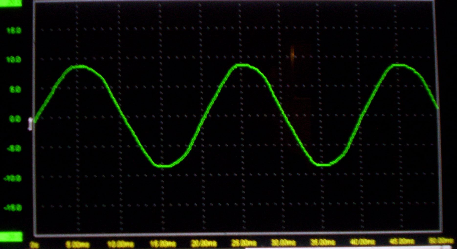

Try this one, i wasn't that close before just cropping the pictures to make uploading them quicker--no broadband where i am unfortunately. I have tried at a different angle & not cutting the picture down so much--hope it works.
