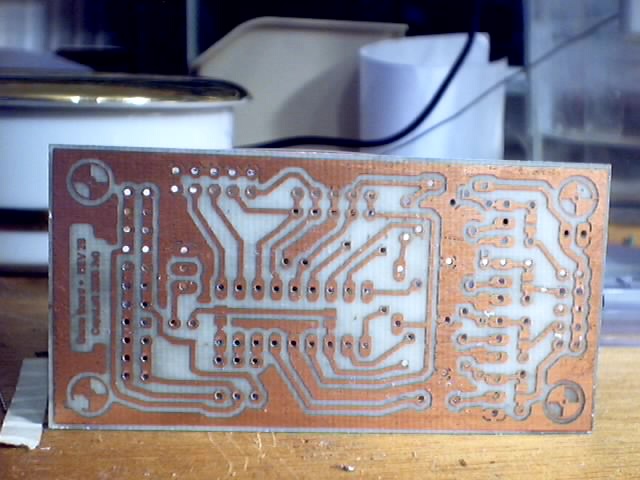

This is an example of a single sided PCB with white Krylon Fusion paint followed by a toner silk screen. I am not suggesting you use paint but it does make the toner stand out.
magicpopulated-jpg.19918
This is the bottom side of the board prior to soldering. On the bottom side use a very light coat prior to soldering and add more after soldering is done.
magicfoil-jpg.19920
I have seen people fail on both top and bottom by using too thick a coat.
