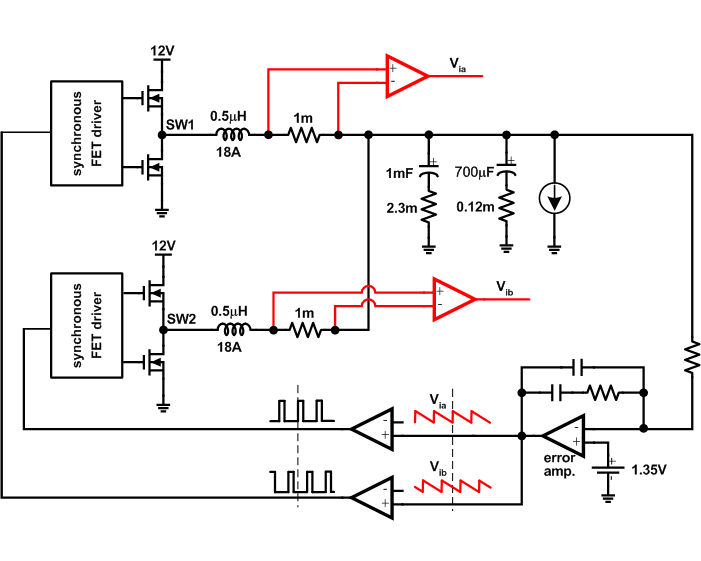

Hi,I have two computer power supply , I need to have +12V 40A. each of them has 20A .
How can I share the current bettwen this two smps?
Somewhere I read an article about this that said we must use one of them as a master and another one as a slave but how?
To use one as a master and one as a slave, the master must control the switching frequency and duty-cycle for both. That means looking at and understanding the circuit schematics to understand how this would be done.
Otherwise you could try placing a small resistor in series with each output to help balance the load. A 0.01Ω resistor, which would drop about 0.1V at 10A would likely work. You could make such a resistor with about 1 foot of 20AWG copper wire.
Howdy, you could also run each through a schottky diode: low drop & no chance of supplies fighting each other.
The master/slave method is better, but with schottkys as well, any transformer difference is negated. G.H. <<<)))

Power supplies that are designed to be used in parallel have extra circuitry inside to support that ability. There is usually an extra pin or two that allows the supplies to 'talk' to each other. They each make small adjustments to their own output voltage so that they each supply their share of the load current.
Otherwise, you can parallel generic PSUs with resistors or diodes but, without the extra internal circuitry, there is no way to ensure that they share the load current equally.

Have you tried just hooking them both up together through amp meters and putting a load on them to see if they pull down nearly equal?
If you can set their individual output voltages to within .1 -.2 volts of each other at no load the odds are their own internal resistances and line resistances will probably balance them out close enough.
I have yet to ever see a pair of matching power supplies where one was so tightly regulated that it would not share output capacity with a second one.
The other thing it that if you need 40 amps of source power I would seriously consider running three power supplies together being that pushing SWPS's designed for computers at their peak operating currents on only one output with no overhead tends to just be asking for trouble.

please look at this:
Orginal site
