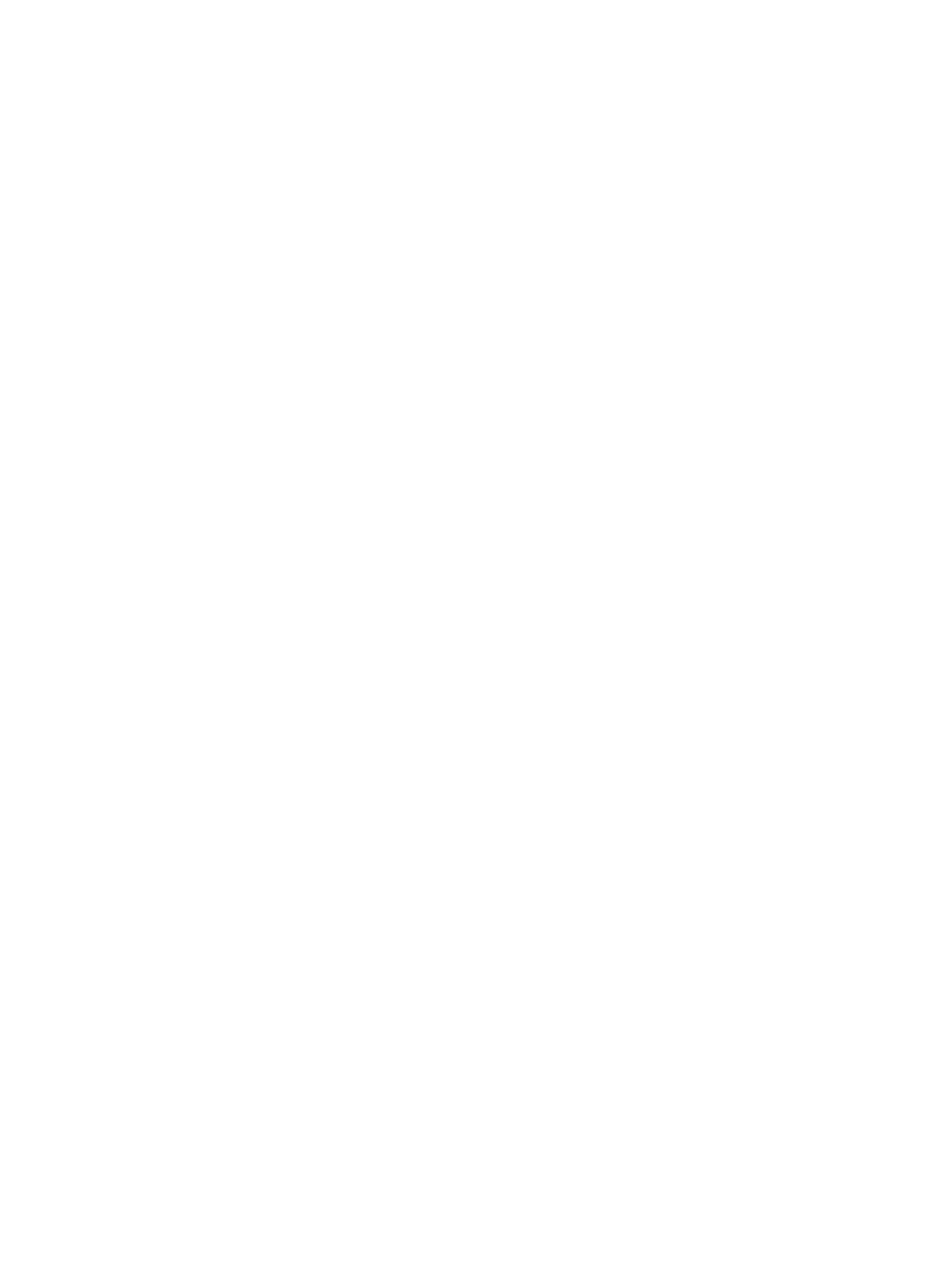

Will you please show me how to wire up in drawing? I know Im not good at it.
Lionel
Lionel, sorry for delayed reply.
See attached drawing...
Edit:
If you cant open the pic in explorer, right clik & "save as"
Blank picture
The link is not blank its, just the thumb image. it happens with .gif images for some reason.
Lionel,
I should have mentioned:
This scheme still may not work satisfactorily if the trim adjustment is too coarse, but you will have to test this your self.
Also test the working at a lower current say 8A or less so that 1 converter is not going into current limit while setting up.
A condition that may exist when paralleling converters for extra current is where 1 converter is running in current limit & the other converter supplies remainder of load. This is not ideal.
Let us know how you get on, I need to implement a scheme similar to this for some new installations soon but at a much lower voltage.
