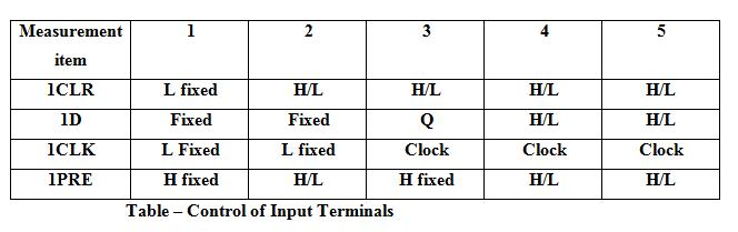

Rise Time, Fall Time
In the SN74HC74, the rise time and fall time can be measured in the circuit configuration that we design, but i have to know how to read the table in Control of input terminals (truth table)
what is the means by fixed on the table??
any explanation of this table

H means that the input is at a "High" Logic level
L means that the input is at a "Low" logic level
fixed means that it does not change.
H/L means a high to low transition
In a 74HCxx part if Vcc is +5Volts then the threshold for logic levels should be close to Vcc/2 = 2.5 Volts. That means that any level greater than 2.5 volts is considered a high and any level less than 2.5 volts is considered a low.
In most SPICE packages rise and fall times are behaioral parameters. That means you set the values to whatever you want them to be. They are not, repeat NOT, the result of simulating a model of the 74HC74 built from individual transistors.
