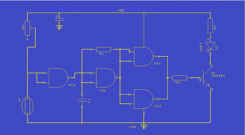

Why not use a Cmos Schmitt-trigger 2-inputs NAND or NOR gate to make a simple oscillator (one resistor and one capacitor) with one gate's input and it can be gated on and off with the LDR on its other input? When the lighting is dark then the Cmos ICs draw almost no battery current. But your circuit with the 555 ICs draws a fairly high battery current all the time.
Here's my interpretation of Audioguru's idea:
Integrated circuit U1 is the CD4093 Quad Schmitt NAND. Transistor Q1 can be any general purpose low power NPN eg 2N3904, 2N4401, BC107, BC337, BC547 etc. If Vdd = 12V then R2 can be 4K7 and R3 2K2. R1 and C1 determine the flashing rate. You will need to experiment with different combinations to get the frequency you like, but as a guide try C1 = 1uF and R1 = 10K. The value of potentiometer VR1, which will typically be a PCB mounted trimmer, will depend on the value of the LDR. The idea is to adjust VR1 so that the output of U1a is low when the LDR is in darkness but high when the LDR is illuminated. The output of U1a will gate the oscillator comprised of U1b, R1 & C1 on (or off). U1c & U1d act as inverting buffers. The transistor is to provide the LED with the current it needs to be brightly lit while at the same time lightly loading U1c & U1d.
