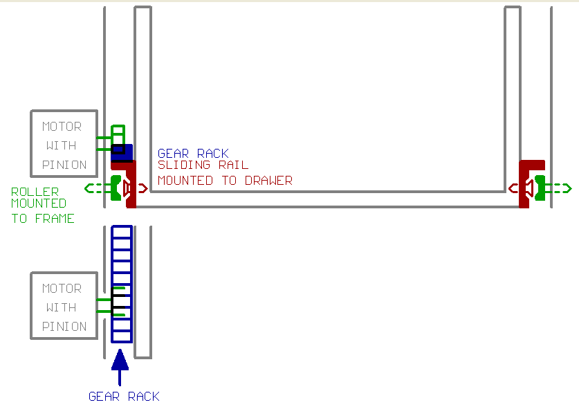

That sounds really good but I really wanted to make it automated so the drawer opens and closes when the switch is pressed. Any ideas on that?
You could use a small motor with a pinion and and gear rack mounted to the drawer as used for sliding gates.
The drive will work fine provided the drawer moves on ball rails which are used for furniture.
Mount the motor with the pinion as close as possible at the front end of the drawer to avoid an overly long gear rack.
Use limit switches and a control circuit reversing the motor to be operated with one button.

The pinion gear method takes care of smooth movement in and out and omits one part with lots of wear and tear (spring), which must be almost as long as the travel of the drawer.

I was thinking along the lines of cutting an automotive V-belt and laying it down as the rack gear, affixing it to the bottom or side of the drawer, then using a geared motor, find a drive gear whos teeth fit the teeth on the v-belt. Wallah! 1 super sized cdrom tray ;)

Thats an awesome idea, nice and simple with minimal parts. So far this seems like it would work best. Now what do i use to time the motor so it only operate long enough for the drawer to open?
Use limit switches.
Little switches that get tripped when the drawer is all the way out, and another for all the way closed.
Look up micro switches , and limit circuits.
They can open the relay coil to kill the motor when the drawer reaches the proper point. When you hit the "close" button, it will switch the DPDT relay and provide momentary power to get the drawer off of the limit switch. Then it will close automatically from that point. Stopping when it hits the "closed" limit-switch.
