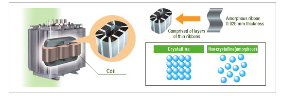

So why did you depend solely on the metallurgical definition to answer an electronic question? Certainly, the context of the original question indicated the OP used the term ferrite to refer to the ceramic compound.
It may also be interesting to note that the iron used today in transformers is not predominately ferrite, i.e., a body-centered cubic crystalline structure:
John
I stand to be corrected. My understanding was as stated.
