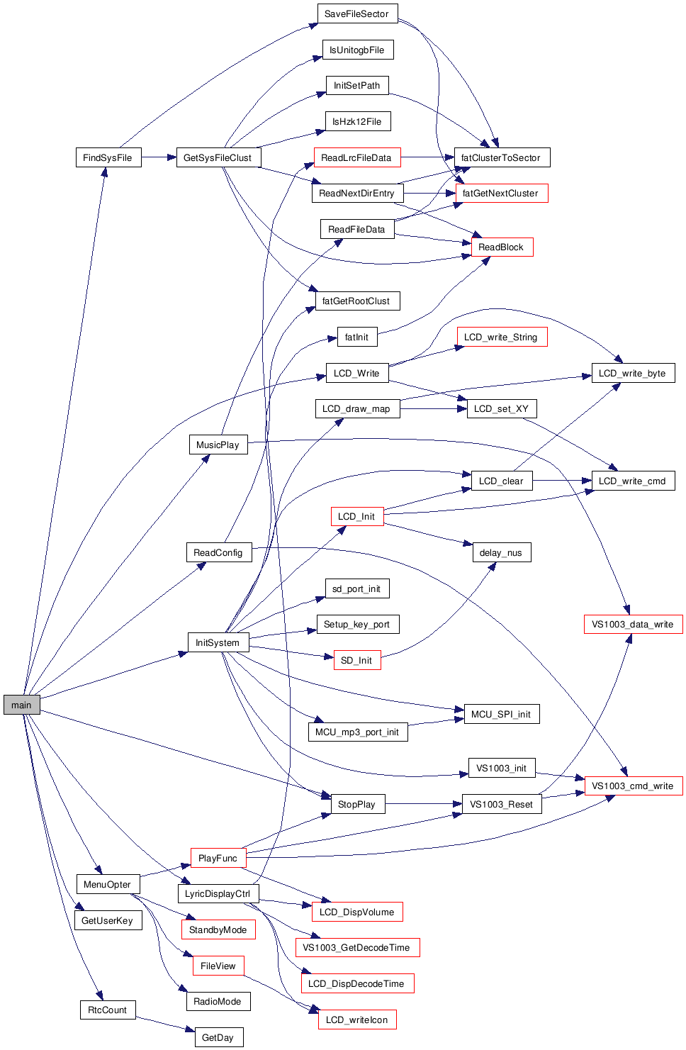

During the very short time between the start and finish of your posting, your issues has already increased to 5. I'm not a bit surprised very soon these issues will multiply like mad.
Just to show you a taste of what to expect, I have attached an image. It shows a MP3/SD design using VS1003 as the MP3 decoding chip, not unlike your present project idea but with added feature of lyric display on the LCD while a MP3 song is playing.
:) :) thanx alot for the picture brother..
but certain things has to be edit in that diagram because we are not going to do the LCD display part as well as the user nevigation part.. That is we are not suppose to get user control where only plug and automatic play capability has to be implement. User intervention with the device will not be expected..:D well thnax a lot for the info;) ;)

The design need only be that complex if you're using FAT files. To simply connect to an SD/MMC card and write/read data...it's pretty easy.
As was also pointed out, there is DOS-on-a-chip...I think SparkFun has it.
