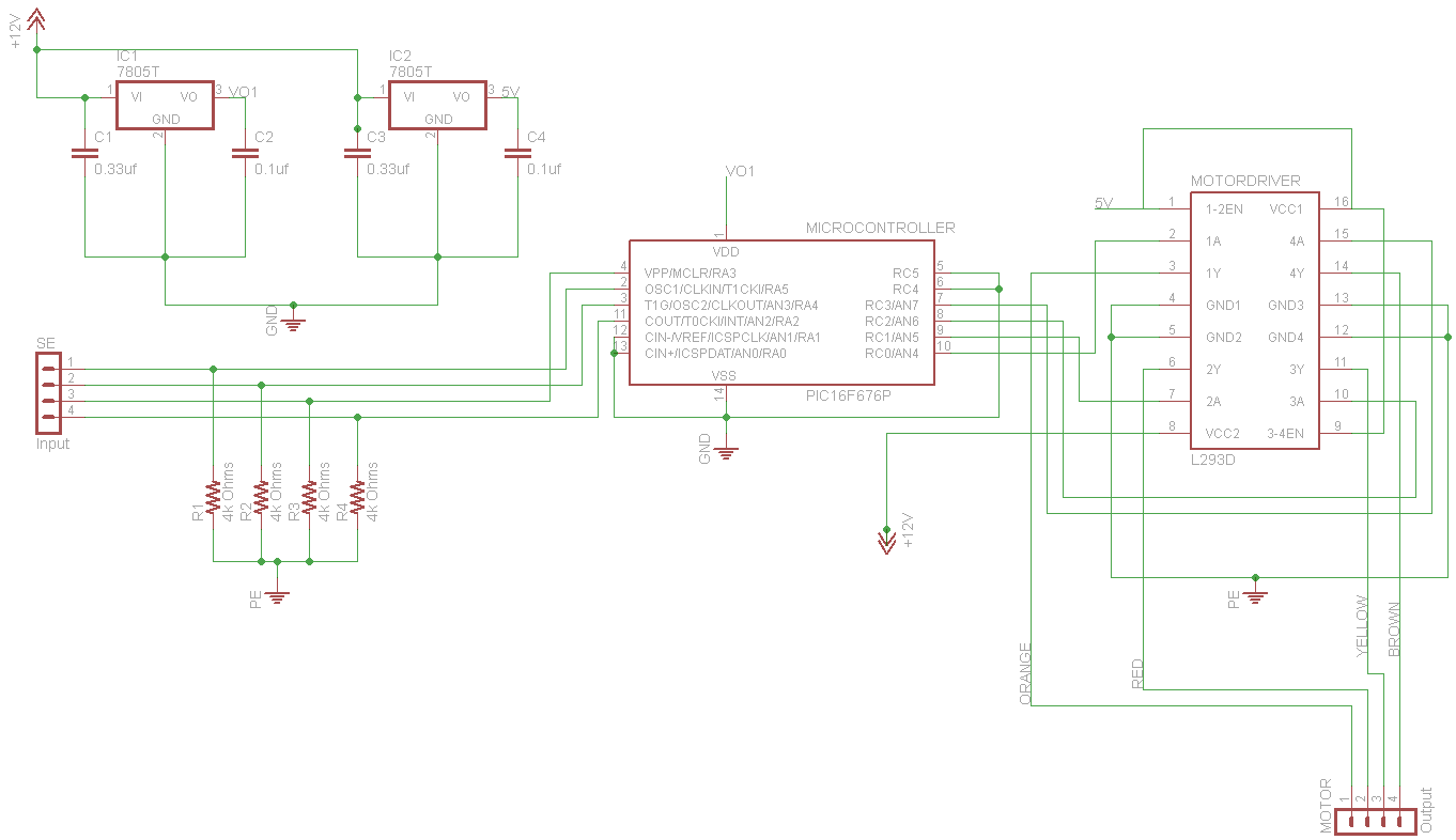

I m using L239D driver to drive my stepper motor. My motor rotate very slow. 30sec/rotation. How to increase the speed of my motor. Have tried reduce the delay loop to increase but it doesnt work. I need your advice and help on this.Thanks

I m using Unipolar motor. Its a 12V motor
I have connect connect 12v to Vs and 5V to Vss for L239
My motor rotate very very slow

The L239D is more suited for bipolar steppers, but as far as I'm aware it can be used for unipolar as well, although you're wasting half of the chip. Post a drawing of how you've connected it all up.

My Circuit and Datasheet
I have attached my Circuit diagram and also my Driver & Motor's datasheet for your reference. Thanks for your help

The circuit looks reasonable, what about your code?.
Rotate1 MOVLW B'00001000'
MOVWF PORTC
call Delay
MOVLW B'00000100'
MOVWF PORTC
call Delay
MOVLW B'00000010'
MOVWF PORTC
call Delay
MOVLW B'00000001'
MOVWF PORTC
call Delay
goto ACWTurn
This is the loop i m using to turn the motor
I even tired to play around with my Delay
Delay
DECFSZ CounterH
goto Delay
DECFSZ CounterL
goto Delay
return
CounterH and L i tried changing to 0x02 but still the same speed
You need to sort your delay out, so you know what the delay actually is, and understand how to adjust it's delay - altering BOTH isn't going to work correctly.
