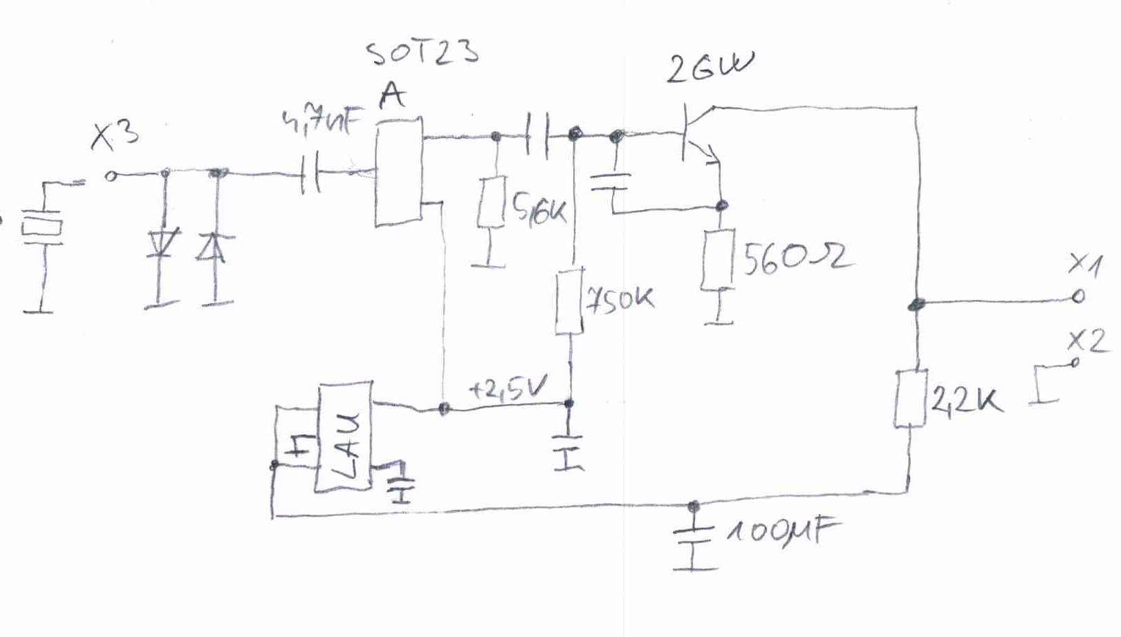

I have a shorted sot23 with only the letter A written on top.
After hours of searching online, I haven't found anything with only the marking "A" on top.
How do I identify this component and find one to replace it with?
Thanks.

By the way... could your SOT23 on schematic be a double diode ?
The only thing to make it through those two diodes at X3 would be high a frequency drive depending on direction. As for the SOT markings could represent anything really, all tho just for a slim chance possibility (this is guess working the part!) The A marked SOT-323 under Motorola NPN RF 8GHz, MRF947.
