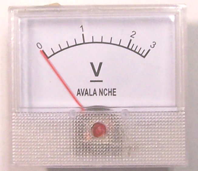

I bought this meter today. It is already displaying 3 volts if 3 volts is applied to it. The resistance of the coil is 3370 Ohms (maybe the coil plus a built in resistor) and the current mesure .000839 Amp. when the needle is on 3 volts. These are my measurements. They are approximative.
I would like to mesure up to 8 volts. So a 6,17K resistor should do it. I will then have a reading from 0 to 8 volts. Right?
But what is interesting me it to be able to monitor the voltage from 6 to 8 volts only. So instead of 0 to 8 volts, I would like the total range of the meter to be from 6 to 8 volts.
How can I possibly be able to do that? If I can do it with a zener diode, please explain how.

There is a 2,96 K (+/-) resistor in the meter but it has been easy to bypass it. Now the meter is "clean". His coil resistance being 392 Ohms it will indicate full range, the (not relevant anymore) 3 volts mark on the meter, when 0,33 volts is apply to it.
With the proper zener diode and resistor I should now be able to use any portion of the meter that I want to display as being the green zone.

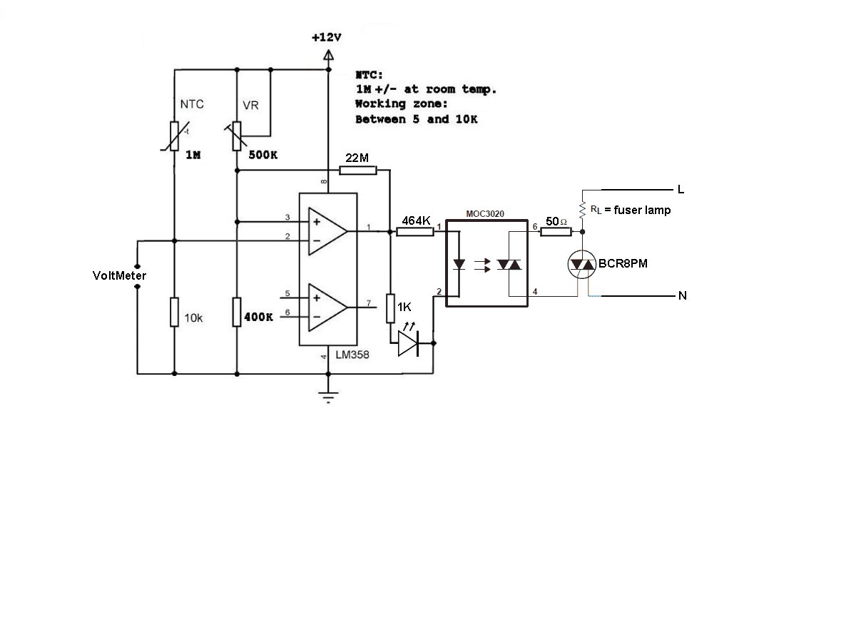

Here's where I am with my circuit now.
I tried the meter yesterday, with no zener diode, and it was working. I could see the needle move up and down but just a little bit, the scale being 0 to 8 volts. I dont know if the zener will change something.

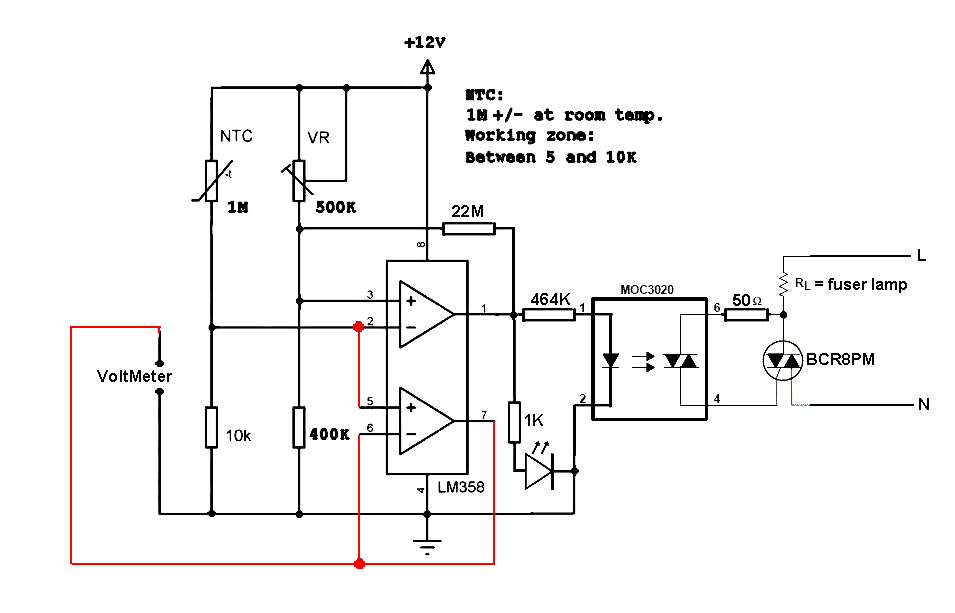

Hi AlainB.
Wire your meter like the following circuit and you can isolate the effect of the meter on the set point of the circuit. You don't need to readjust the VR every time.
It uses the leftover opamp to form a 1:1 voltage follower.

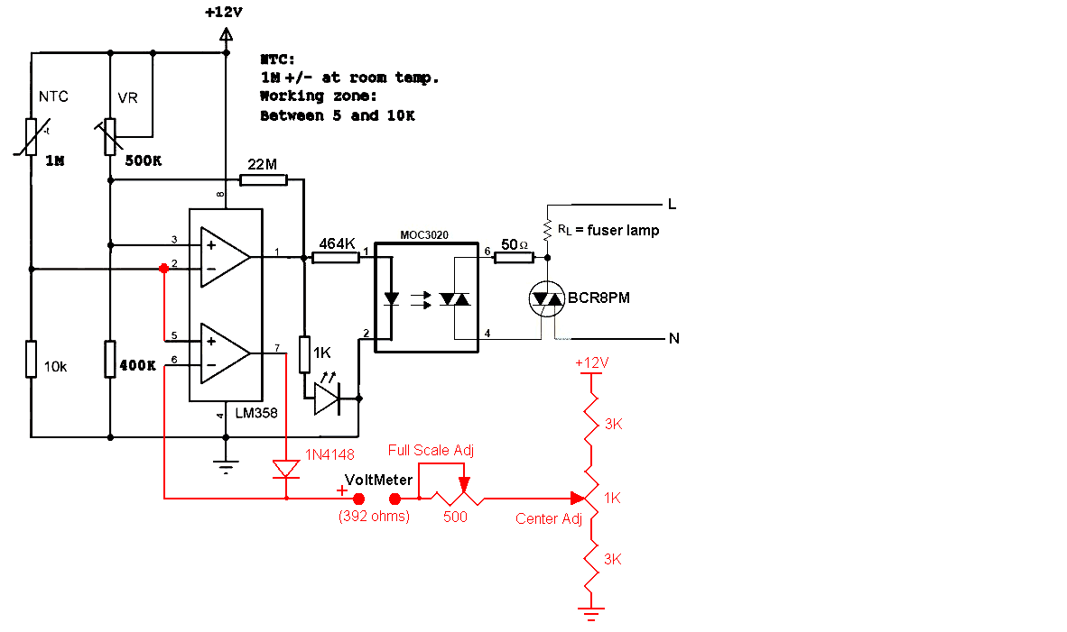

Great idea, eblc. Expanding on that, the meter can be made linear (as linear as the movement is), and adjustable, with the circuit below.

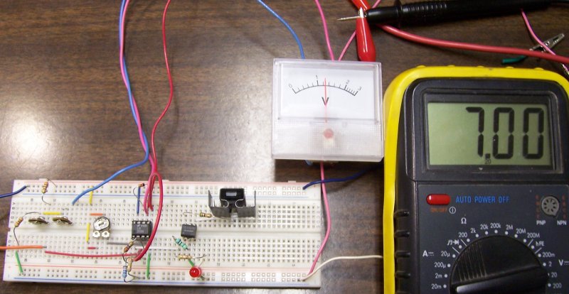

Yes, it is a great idea and it is working very well. Plus, isolating the meter circuit from the fuser lamp controlling circuit add a very good insurance against murphy's law.
Roff, I added your circuit and it is working also very well. I now have my 2 volts range, from 6 to 8 volts and, as a bonus, I can ajust the needle to be in the middle of the meter when 7 volts is applied. The meter cannot be made linear though. I dont think that there is any "electronic" left inside. Just his mechanical properties. But this is not very important for my usage.
What would I have to change to have say a one volt range instead of 2? And what is the purpose of the diode? I suppose it has to do with your circuit being connected to 12 volts somewhere? Or is it the inverse??
Thanks!
Alain

See schematic below for 1V range. If you don't want the full scale adjustment, I can post a schematic which eliminates it, and just leaves the center adjustment.
The diode linearizes the circuit (excluding the nonlinearity of the movement, of course).

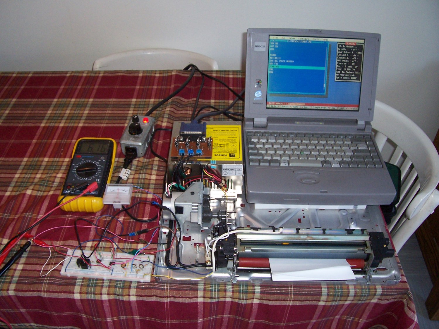

Here is a picture of my monster machine in action with the new circuit. Not really transferring toner to copper. Just faking. I have it work at low temperature for now for testing. Maybe around 120 C. The operating temperature will be around 180 C. It is the normal operating temp. of the HP laserjet when in printing mode.
The circuit is working well. As is, the green zone of the meter is big enough. The needle is going nicely back and forth on about one third of the total range.
