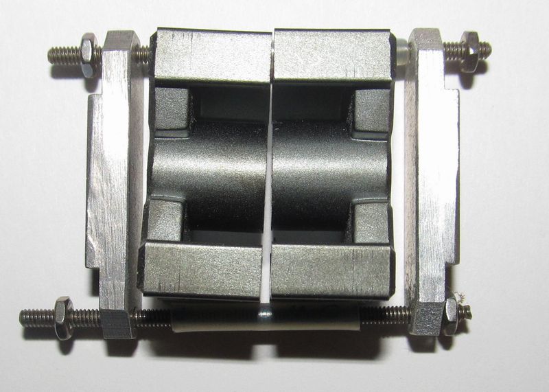

I just use an Aluminum Plate on each end, drilled on each side for a screw on the sides.
two Long Stainless Steel Screws with Nuts holds these nicely.
The Aluminum and Stainless Steel won't affect the transformers performance.
No Glue and it can be taken apart if ever needed to do so.
This is what Flyback is talking about. The bobbin is such that tape will not work. There is no place for welding or screws.
Use the clips! There really is no other choice with this bobbin.
