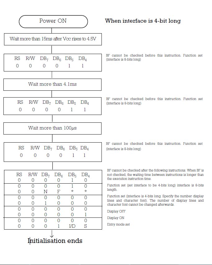

The initialization of the LCD needs some delays inserted.
From the data sheet,
HTH
Hi Mike,
Sorry I do not understand what it means. What is BF (is it busy flag). Please note I am not a professional programmer. Can you please give me a better explanation.
You need to go through the initialization sequence exactly as in the table.
void LCD_init()
    Delay15MS();
    LCD_cmd(0x20);                  // 4 bit
    Delay5MS();
    Delay1MS();
    LCD_cmd(0x28);                  // display shift
    LCD_cmd(0x6);                   // character mode
    LCD_cmd(0xc);                   // display on / off and cursor
    LCD_clr();                      // clear display
I just noticed that Ian has a delay in LCD_cmd so you may not need the delays but you do need to write 0x20 three times.
I just noticed your connections. D7 to B0 isn't going to work without a big rewrite. D7 to B7 etc. is what the code needs. If you need to use D7 to B3 then the code will need a little tweeking.
If at all possible... You need to swap those pins around.. MikroC allows single bit data bus, where as I didn't..
If you cant move your pins, I'll see if I can do a bit write to them.... Even the builtin "XLCD.H" doesn't allow for this kind of connection....

Are you using ISIS??? Your delay routines are set for a 4Mhz crystal! When using an 8Mhz the delays were all half of what they should be....
Use this init() routine for ISIS ( Very low tolerance ISIS!!)
Here is the whole code working!!

BTW: I have changed data pins to D4-D7 and RS,EN and RW to B0,B1,B2 (PORTB)
[/CODE]
I assume the above was a typo and you meant B4 to B7. However, you didn't say which way around you connected them. You need D7 to B7, D6 to B6 etc.
Nigel:
You're doing something wrong somewhere :D
Thanks Nigel, I got it working and I am glad that I have asked the question in the right forum where lot of good programmers and designers willing to help beginners like me :).
Ian:
Just keep going just a little longer and I'll point you in the correct direction....
Thanks Ian. I really appreciate your words and finally I got it working. I believe it was the delay routines.
Ian:
Just a mo!!!
Yes you are right. And I didn't realize that proteus simulation can cause so much headache. I build the circuit on a proto board and the pin arrangement is different to what I have used here. I do normally run the simulation on Proteus before flashing the uC .
Mike:
Yes Mike that was a mistake. in my proto board the connection are like follows.
B7 - RS
B6 - EN
B3 - D4
B3 - D5
B1 - D6
B0 - D7
currently the code runs with the pin arrangement sown in the attachment and I am trying to modify the code so that I use the PORT and pins in any order.
Thanks everyone for helping me. I believe I have lot to learn......

Hi All,
I have found a way to assign LCD port to the way I want initially, which was:
B0 - D7
B1 - D6
B2 - D5
B3 - D4
and B7 - RS, B6 - EN , B5 - N/A or RW. Here is the code and please let me know if you know how to do it better and optimized way.

and the final result is something like this:
Thanks.
