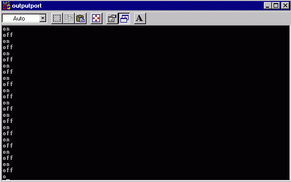

i have a written a program
if you use the parrallel port you can output 10 bits at a time i have written a program that can output your processer speed (max) to the parralel port
(attachment) this will do what you need
connect pin 2 to your logic or transistor and the ground to pin 25 (case)
note: the program only work if the dll if in the same folder and the higher the number the slower it will go eg: my processer speed is 320 mhz (3.2ghz) so 1 will 320 mhz.

I suggest you check on PC specs, the ports run at a MUCH slower speed than the processor, it's limited in the PC design.

For a start, 3.2GHz is 3200MHz, not 320MHz, and you won't get anywhere near that from a parallel port. The 3.2GHz refers to the processors internal speed, even it's external access to fast memory is a great deal slower than that.
sorry got that wrong.
when i checked my port it was 3000MHz my processer is 3200MHz
i just assumed.
danielsmusic, What have you done?
I connected an led and resistor to pin 2 and earth.
The led flashes at the same rate, no matter what the delay period.
Why is that program 1/2 Meg (unzipped) in size?
you will need to change the nuber quite alot for it to work 100000000 will flask twice a second i will write another program to make it easyer

it is in milliseconds this time
1 = KHz
0.1 = 10KHz
0.01 = 100KHz
0.001 = 1MHz
and so on...

And AFAIK, the parallel port runs on the PCI bus in current pc's wich is locked at 66Mhz (and the parallel port is even slower then that, for compatibility's sake)
I have not tried such a program before, but I'm quite sceptical of not only the maximum bit rate of the parallel port, but also how precise can you output to a parallel port (in terms of timing) in a non-realtime multi-tasking windows/linux environment. BTW, are you positively sure the program can work at 3Gbps? If it's true, then it's amazing. Can dump all those expensive DAQ cards straightaway. :lol:
i know defenetly the program work at the prosesser speed but the paralell port cannot
the program timing is "perfect" this time
