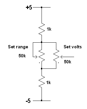

Do you have a ganged double pot? (look at my previous post again)
If not, I can think of a solution that uses two pots, one to select the endpoint +- values symetrically, and the other to select the voltage that varies between the endpoints.

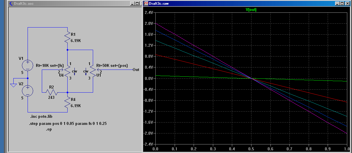

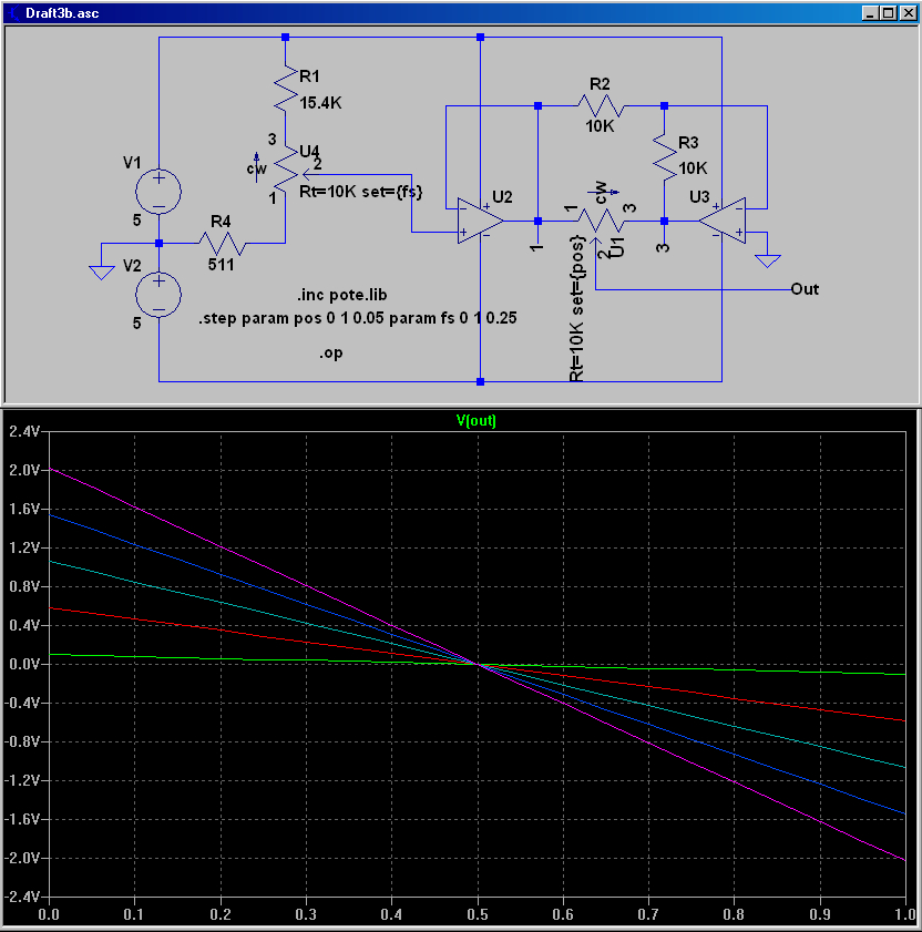

The x axis is the value of "pos". The green trace is for fs=0, red fs=0.25, ... , violet fs=1
Thanks Mike, I will put together a test circuit on a breadboard and see how it performs. Hopefully this will work out fine for me.
If the 100mV level setting isn't too critical then here's a simple alternative way, giving a range from +/- 0mV to +/-4.9V.
Expanding on Alec's circuit:

Thanks Alec and Mike. Both circuits work fine. Could anyone of you guys explain me how you came up with those values which is what I am wanting to know.
thanks
How did you come up with 6.19K, 243, 10K pot & 50K pot values? That way I can change them so that I can set the upper limit (now its at 2V with your values) to lower than 1V, that way I can get more resolution on the output.
Can I use a 40K trimmers in place of 6.19K resistors to change the upper limit without changing any other values or is there any other easy way to implement that?
thanks.
I put the circuit in LTSpice. The goal was to find resistances that hit the 0.1V and 2V limits as U4 is varied. I could play with R1 (and R4), R2, and the ratio of pot U4 to pot U1. I just used trial and error, and it converged to the final values quickly.
I could have written three equations in three unknowns, and solved the equations, but I would probably still be trying to find where I made a math mistake... :eek:
A few more iterations gives R1=R4=16.5K and R2=732Ω

Thanks Mike, I ended up with those values for 1V at 16.4K, but haven't changed R2 though. So, what would be the range of R2 if I use 50K POTs in place of 16.4K, that way I can have a POT in place of R2 too.
One more last question regarding this, is it OK if I use four 50K POTs in place of U1 if I want to use this set range for 4 different channels? Soo basically it owuld be four 50K pots in parallel to Pin1&3 of U4?
Paralleling four 50K pots would result in an effective resistance for U1 of 12.5KΩ, so that would necessitate re-figuring everything. Just use four 200K pots in parallel; that makes 50KΩ as before...
