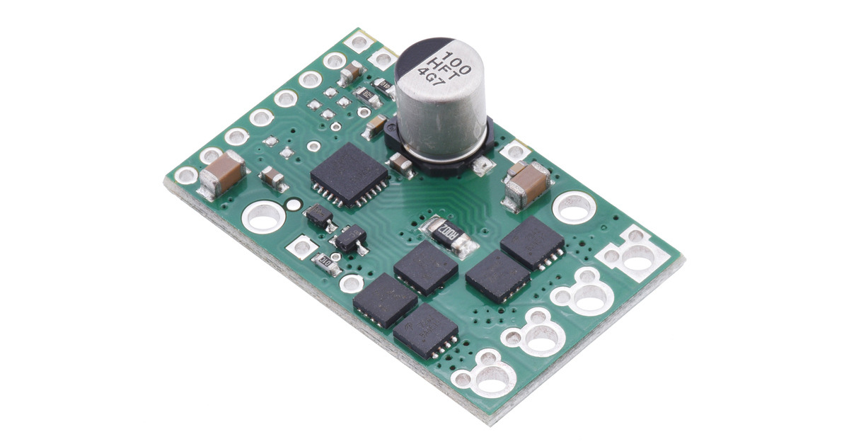

I have a DC motor that came with a speed controller like in the picture. The controller is connected to the motor with a 4-pin connector. Nothing is labeled except the power source which says: 24V 4.17A 100W
I want to replace the controller with a DAC for automation and need to find out which pins of the connector do what. I could just start probing with a multimeter but I dont want to short anything. I also dont want to dissasemble the controller or the motor.
I assume:
1) two pins are power from the power source which supply the controller.
2) the other two pins are the regulated power from the controller to supply the motor and adjust its speed.
My uneducated approach would be to disconnect the controller, power up the device, and test between the pins looking for 24V. Once I find that +24 I dont know where to go from there. I'll have three pins unknown. I also suppose sparks could by flying during this process, which I dont want.
My totally ignorant next step would be to find something with resistance like maybe a 24V 100W light bulb, and test between the +24 and the other three poles. My hope would be to light up the bulb without the motor running. Then I would have found #1 above - the two pins that power the controller.
So then what? Directly wire those two pins to the other remaining pins and hope the motor turns at full speed? And if it doesnt, disconnect as quickly as humanly possible while sniffing for burning smells? Then, directly wire those two pins to the other remaining two pins and surely the motor will turn at full speed, thushly accomplishing the task.
Any ideas?

Disconnected, from the open end of the plug and the motor end, test continuity of the wire and you will find out where they go and what they are for.
Disconnect the motor and controller.Power on the controller alone and measure the 4-pin connector's pins to identify the power supply connections. Look for a steady 24V DC output between two pins.
I took the cover off the part that connects the power supply, motor controller and motor.
Green is ground on the power supply side, chassis ground, and is routed into the controller.
Blue is +24V routed into the controller.
Red is 0 - 24V depending on speed fo motor, routed from controller to motor.
Black is ground routed from controller to motor.

Here's a pic of the controller's board. It supports wifi in addition to the potentiometer.
Maybe I'm making this more complicated than it needs to be. All I want to do is figure out what to replace this controller with so I can use something like arduino to control motor speed. This might be a good choice...
A motor that draws more current will get hot. I guess some controllers model that.
Even though PWM speed controllers are quite efficient, they are not perfect so there is still some heat and heatsinks can be worthwhile. That doesn't mean that the heatsinks would be anywhere near as large as on a linear speed controller.
That speed controller would most likely be fine.
