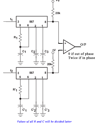

You could also make their levels the same then add them. If the output is double then they are in-phase. If the output is zero or very low then they are out-of-phase.
This is what u r trying to say about the second question's answer.
No. An old LM567 has a low output if the signal is within its frequency bandpass, with any phase.
You need a phase-detector like one of the ones in a CD4046 PLL IC.
Or you could make their levels the same with an AGC circuit then add them in an opamp summing circuit. The output will be double if they are in-phase and will be very low if they are out-of-phase.

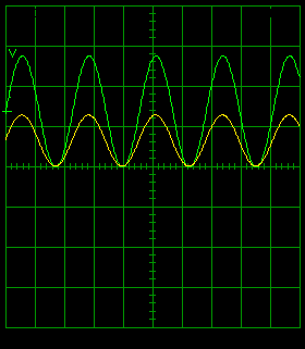

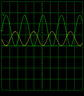

The reference signal has that amplitude 13.84V but the signal to be compared with it have the same frequency but of different amplitude.
See the attached images.The wave in green is the reference wave and the one in yellow is the sine wave under question.Now my question is i need a way to know the amplitude of that sine wave(yellow one) and whether it is in phase or out of phase with the reference sine wave(green one)

It can maximum go up to the amplitude equal to that of the reference sine wave.it will never be greater than that.i.e. from 0(well cant be zero) to 13.8
You will lose the ability to determine phase and amplitude as the amplitude approaches zero. How low do you need to go?
well i know that it will be very very difficult to measure the phase and amplitude as the amplitude of the wave approaches towards zero.actually the range of the sine wave under question has a lower limit of around 2 volts.(actually 1.96v)
So the practical range is 2v to 13.7v
I could design a synchronous peak detector that would output the peak as a positive voltage if the signal is in phase, or as a negative voltage if it were out of phase. Would that be better than separate amplitude and phase info, or worse?
