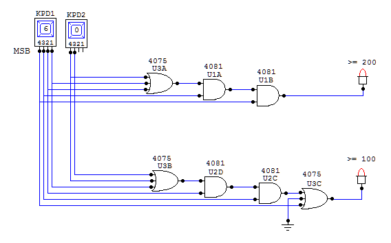

Recently I'm working with a project. there I need tow logic that will determin whether the 8 bit data is 100 or more than 100 and 200 or more than 200. can you guys help me out? :rolleyes:
in this ciruit, i'm able to one set of data is greater than or equal.
but i want two sets of data to compare in this automaticaly. it may be 100 and 200. plz frndz help with this.

The easy way is to have two circuits , one for 100 and one for 200.
Connect the 'unknown 8 bits' to both circuit inputs and 100 to one circuit and 200 to the other circuit
Remember you have 4 states, so you need 4 LED's, so you will need some logic on the = > < outputs.

but i want it in small circuit. not a big one. if i use 4 ICs, then the circuit'll be a big one.

Then you need to do it with a microprocessor.
Or you could draw a state-machine with 8-bit input.

I have seen this done with an Eprom 27c64 before.... You can program the eprom so that every address above 100 = X then every location over 200 = Y.
This way you will be able to test ANY number.... Just connect your 8 bit data to the address bus... output on the databus..... or use a PLA..

You can do it with two ICs if you don't need the =100 or =200 outputs.

I have no idea what your application is but if you could be a little more flexible with your values then it's very easy.
>127, >127 < 192, >192 is simple logic gates.
Digital hardware doesn't tend to be decimal friendly.
A PIC 16F5 series, ATMEL or other cheap CPUs will sort this out in a few lines of code as oppose to what could be a few large chips. It's also flexible in that you can change it at a later day without expensive hardware redesign. For simple logic of this kind, the only benefits are flexible power supplies and low current (4000 CMOS). Otherwise such logic is a waste of board space.

yes i agree with your opinion. but im new in the fields of electronics, just cross 1 year with it. so its very hard to get touch with microcontroller at that time... but im preparing for that. so i also wrote a thread how to start learning micro....

This is a good way but I dismissed on the grounds of size which the OP says is important. A 2764 is a huge IC, physically.
