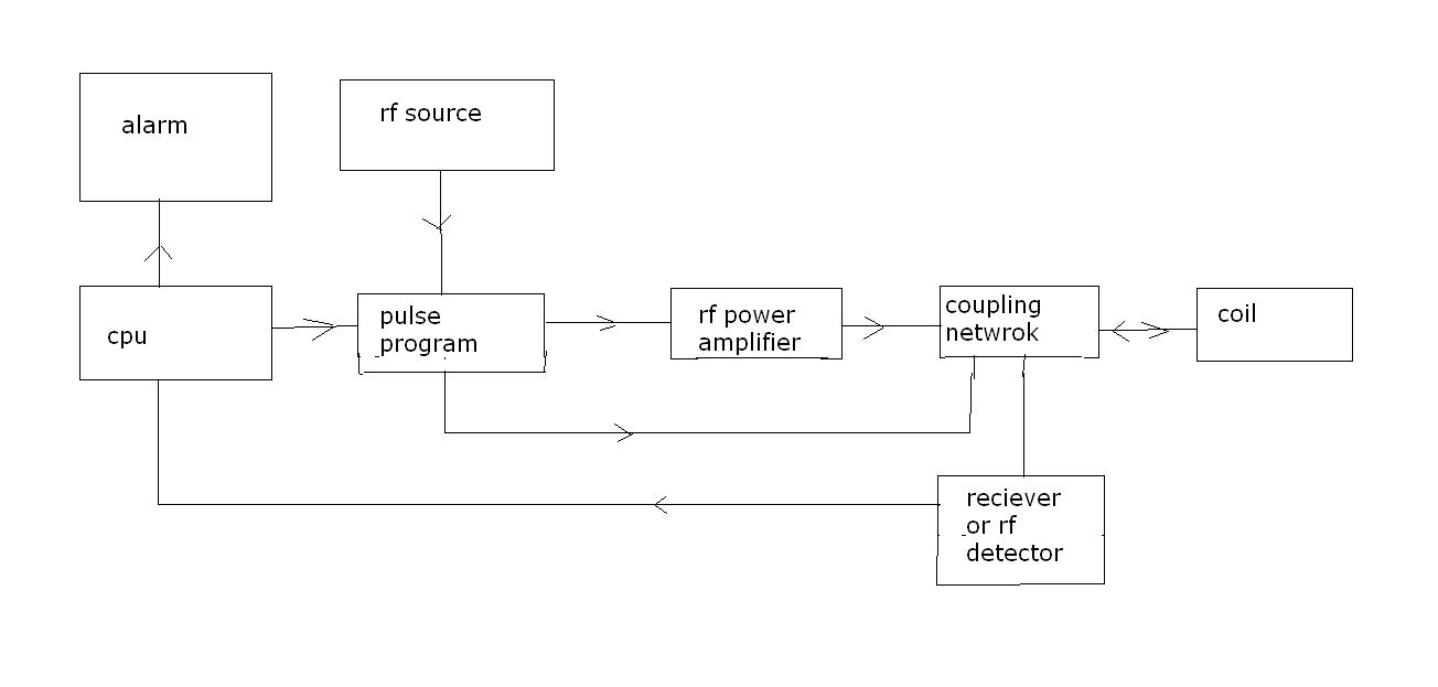

First off, do you have access to a calibrated frequency standard, which is traceable to a secondary or tertiary standard, minimum? Second, do you have at least a block diagram of what you are trying to accomplish? Third, do you have an idea of the exicitation/reception probe necessary for the sample under test and its proximity to the sample? I ask these questions to see how much you already have invested in this project and if you are willing to carry it through to fruition.

block diagram
i have attatched the block diagram..which i think would be capable of doing the same..and yes sir i have the samle of chemicals and also its info that is its nqr freq and natural freq and all the data that would be necessar to carry out the experiemnt

Thanks for the block diagram. I notice there is no provision yet for temperature control of the crystalline sample. Is this an oversight? Also, there is no note of the desired frequency range of the RF synthesizer. Keep in mind that one may wish to vary the frequency somewhat to avoid cancellation of resonant signals or to test other samples.
