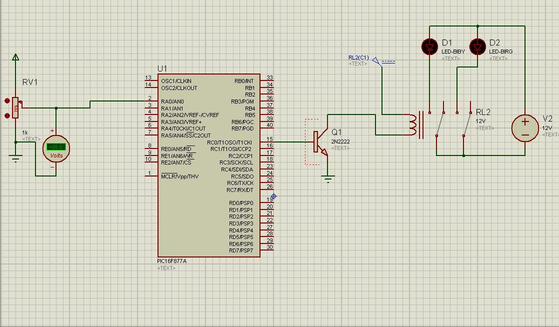

I am new to mcu. I want to make a project for controlling two leds. I am using PCW (Pic c compiler)Please help me to write a code to on/off relay through potentiometer reading(5v to A0 pin). I need to on the relay when voltage is under 1.5v and above 4.5v. here is my circuit.

I would suggest that you break the task down in to sections. Breadboard your circuit and write code that turns the relay on and off, then write code that measures voltage, then combine them. When you run into a problem that you can't solve, post a detailed description of what you expected to happen and what actually happened and I'm sure someone will be able to assist you to troubleshoot it.
I suspect you will want some EMF suppression on that relay coil, or if you are genuinely only looking to drive LEDs then you could probably do away with the relay altogether.

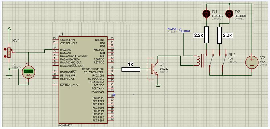

Your schematic is lacking a few resistors, please see my modified version.
You need a resistor to limit the base current of the transistor.
You also need resistors to limit the current through the LED (unless the LEDs already have resistors built in).

You need a diode across the relay coil to protect the transistor from kickback, cathode to +

thanks again the code you provided isn't working like mines but it is better than mine. I am using PIC c compiler. please look at the very first circuit diagram of this page. I need to operate rely for under and over voltage limitations.
