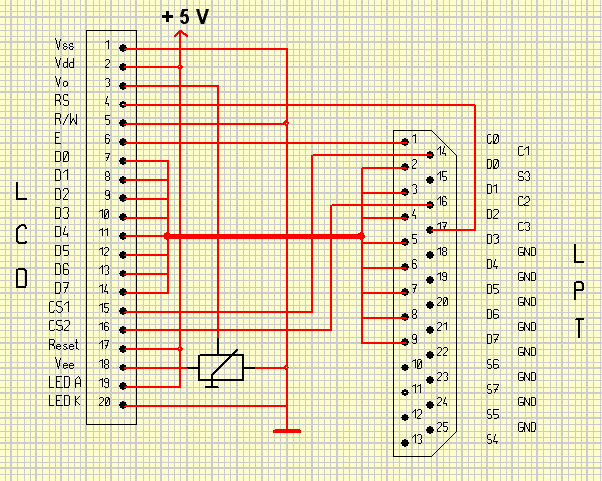

I need some informations concerning Graphic LCD's, do they have some standard like the Character ones ???
Well i recently acquired one (a friend gave it to me), but how you imagine it can be frustating when we have such a nice device and don't know how to start :(.
Here is were you enter :lol: , if you know how to use this fantastic devices help the other starting by me
My Graphic LCD information:
(See the picture too :D )
Picvue Electronics, LTD (Manufactoring Company, Taiwan)
STN Gray
OutLine: 93.0x70.0x14.7;
View Area: 66.5x33.24;
Driving Method (Duty): 1/64;
Interface: 20 Pins;
Pixel Area: 128x64;
V DD: 5V;
V LCD: 12V;
DC/DC Convert: Yes;
Built-in Controler: No;
BackLight Type: EL.
It's not color but it's nice anyway, tell me how can i use it, and their comunication protocols and the datasheet if you can too.
Well, thank you for your time.

Lucky You, I wish I was able to find that type of data when I have an unkown LCD :roll: :
1 Vss,
2 Vdd, +5
3 Vo,
4 DI (RS),
5 R/W, H - , L -
6 Е, H -> L
7 - 14 D0 - D7,
15 CS1, #1
16 CS2, #2
17 Reset,
18 Vee, -10V
19 LED A, +4,2 V
20 LED К,
Part Number : PVG120602EGE
Outline Dimension : 93.0x70.0x14.7
W x H x T (mm)
Viewing Area WxH (mm) :70.7x38.8
Active Area (mm) :66.52x33.24
Driving Method (Duty) :1/64
Interface
:20Pins
VDD/VLCD (Volt) :5V/12.7V
DC /DC (Convert) :YES
Build-in controller :NO
Back light type : EL
LCD Type :STN Gray
I am sorry but my russian isn't very good!!!!! Here is the **broken link removed**,so I let you translate that :lol: .But you can tell what is what, check attached files as well. Go to http://babelfish.altavista.com/ and chose Russian to English then in the "Translate a Web page" put **broken link removed**
Have fun this weekend!!!! 8)
Ivancho
