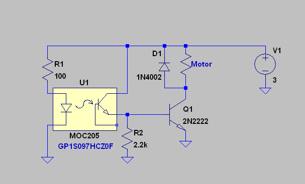

Ok, so you want a NOT(beam break detector):D
I recommend one of these, followed by a NPN transistor to drive the motor
Will the motor always turn in one direction?
Are you trying to use the IR emitter and detector to create a beam-break detector (Photo interrupter)?
Thanks for the suggestion. I am just not quite sure what it does and how to use it?
Think of it as a switch that is closed when nothing is inserted in the slot. If you put something opaque in the slot, the switch is open. Adding just a couple of parts (two resistor and one transistor) will allow that switch to control your motor.

Bad news! No simple dc-coupled IR LED and IR detector has a range of 5ft, unless it has very complex optics with beamwidths of less than a couple of degrees (making hard to align). The IR detector is usually swamped by ambient radiation from lighting and sunlight.
The only viable way of getting a range of several feet is to use the method used in IR-based remote controls such as on your TV set, where the emitter LED is pulsed on/off at an ultrasonic rate (usually ~40kHz), and the detector is AC-coupled to a narrow-bandwidth, high-gain amplifier tuned to 40kHz.
